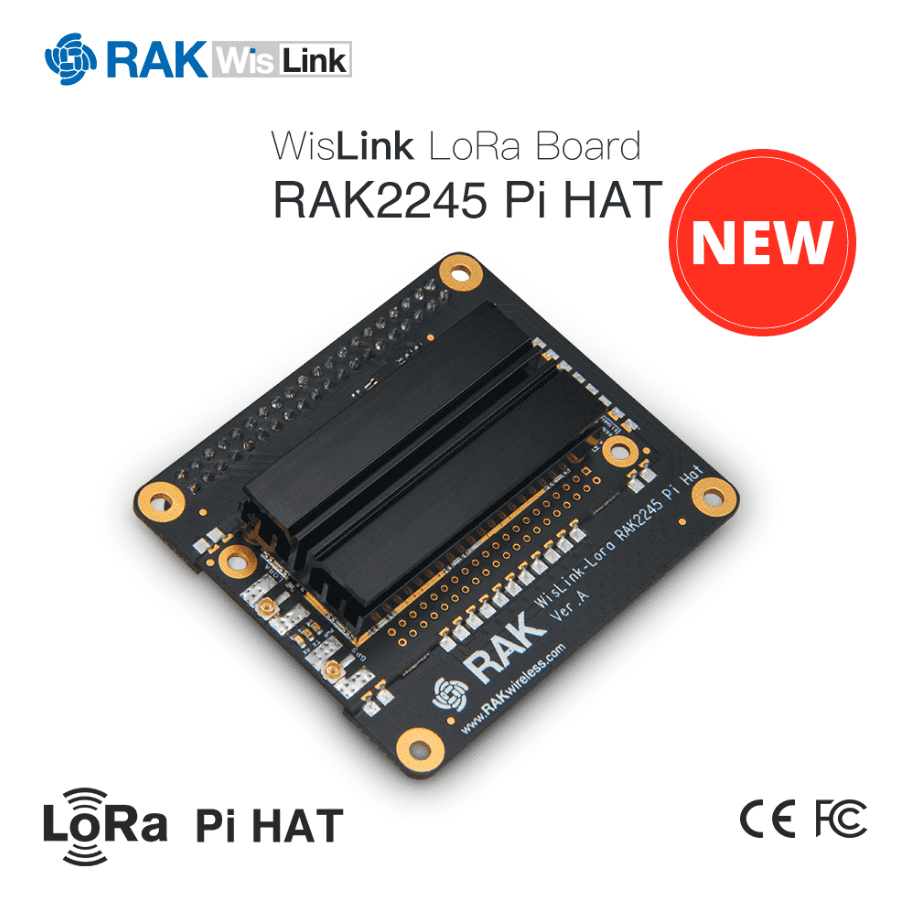

I currently have one of these RAK2245 pi hats running on a pi3b in my server rack connected up to an external antenna.
RAK even have a downloadable raspbian image with the router software ready to go if you don’t want to stuff around - just add your ttn gateway credentials.
The standard antenna was hopeless for me partly due to positioning of the device which was pretty much in a faraday cage and range reduced to around 400m.
