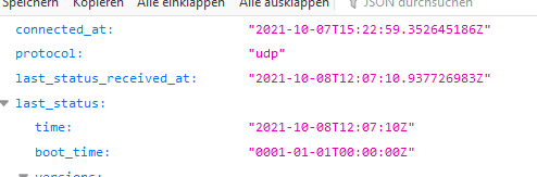

When I enter the url in my browser, I can see some information about my gateway:

ecosoph
(Markovicz)
3
Sorry guys…
Here is the working solution, just put the api key in the header.
Reference: Using the API | The Things Stack for LoRaWAN
