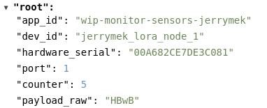

And I can verify the correct transfer in the data tab of the Application:
Now I try to setup a HTTP integration to the request.bin but the raw data received does not match up:
Any suggestions what can have gone wrong?
Thanks!
Jerker
Hi Jerker,
payload_raw is the base64 encoded payload.
So you have to decode it to be able to find your hex data back (hexadecimal is just a way to represent binary data).
