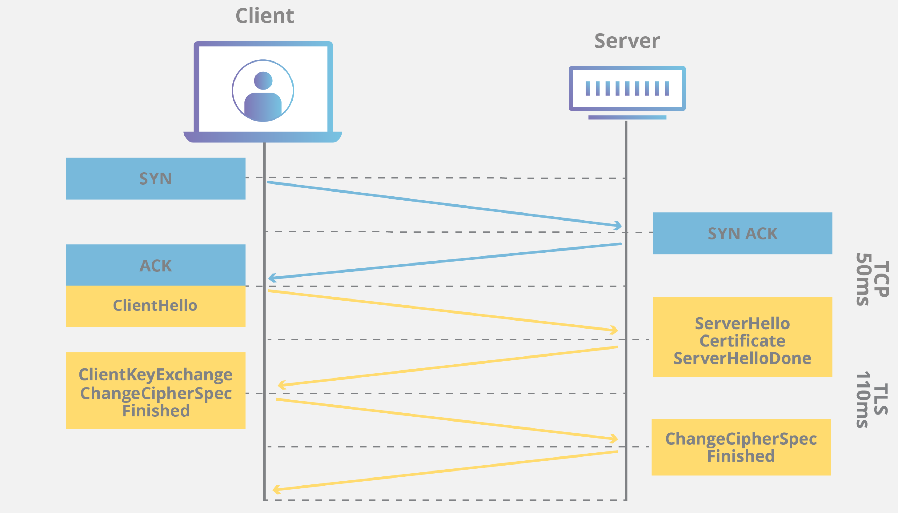

Hi, doesn’t the MQTT Data API run from the same Azure hosted VMs in Ireland just like the HTTP end-point? I am just trying to wrap my head around how MQTT Data API could produce a better latency compared to HTTP calls? Thanks
A mqtt connection is persistent. For a https request, there must first be the three-way TCP handshake, then the TLS handshake, before the request can be sent.
Since mqtt performs the tcp and tls handshakes once (when establishing the connection), the connection is available for sending data immediately when data comes in from the device.
Cloudflare has a good description:
TLS handshake
https://www.cloudflare.com/learning/ssl/what-happens-in-a-tls-handshake/
