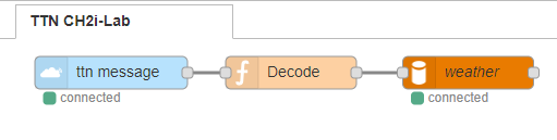

For this (and any IoT action) I would use node red doing something as simple as that
Check this link
Decode function should be something like that

correct, but it was just a sample to help I do not have any table, and my sql instance is firewalled only with my admin IP :slight_smile:
but anyway no sql admin would allow internet user to delete data or tablel not ? :wink:

@arjanvanb
Sorry my fault, the Node Red TTN in my stream was over MQTT not HTTP, since the goal was to insert into mySQL data from TTN. Even if original question was with http integration worth mentioning other simple solution can work.
By the way, I do not consider my example as bad, since data (payload) is parsed by a function in between MQTT and mySQL Insert. Each payload byte is decoded to be transformed by number so whatever you push in to the function, I think you would never be able to do any SQL command injection with dangerous commands in this example :wink:
Afterward of course the transfer between the output of Node Red to MySQL is relevant to network security and all rules applies (authentication, encryption, firewalling, …)
