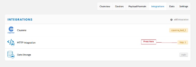

HTTP Integration
In your application in TTN Console, go to the “Integrations” tab and add “HTTP Integration” (or click on the one you added earlier as seen below)

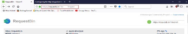

Go to https://requestb.in and set up an endpoint
After setting up requestb.in, you will get a webpage endpoint like below
Go back to the TTN console and enter the webpage endpoint as below (without the ?inspect)
Send some data and go back to Requestb.in. You will see some data now.
