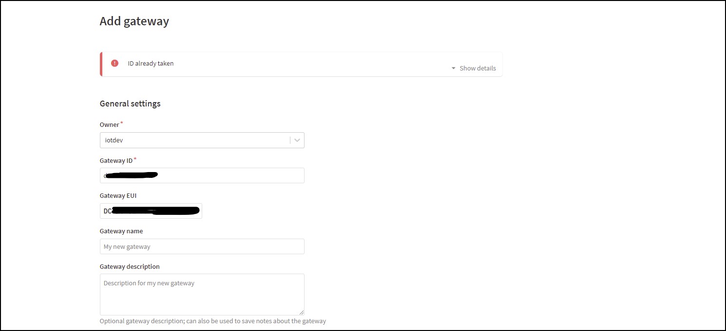

I completely deleted my gateway and tried to enter it again, but it doesn’t accept it
Bit sparse on detail here - what makes you say ‘it doesn’t accept it’?
Sorry, let me explain better.
I no longer have my gateway in my console.
When I go to enter the gateway again, I always get the same error.
I also try to enter my gateway with the old name, but probably I had entered the name differently and now I can no longer enter my gateway.
Is it possible to delete my gateway from the database to be able to insert it?
What error - it could be any number of messages that you are getting - DETAIL! What are you entering, what is the error message. Do NOT use a screen shot, just copy & paste it over.

Error is:
"code": 6,
"message": "error:pkg/identityserver/store:id_taken (ID already taken)",
"details": [
"namespace": "pkg/identityserver/store",
"name": "id_taken",
"message_format": "ID already taken",
"correlation_id": "4aa4774cc8f44e148db91ee61e57a7be",
"code": 6
"request_details": {
"url": "/users/iotdev/gateways",
"method": "post",
"stack_component": "is"

So you have all the answers then, you can’t reuse an ID that’s already in the database and the unformatted error message you posted says it’s already taken. So use a different ID.
You didn’t tell us what you were entering - as there is a blacklist of IDs you may be hitting but we can’t tell because of the lack of detail.

I am try to readd my RAKWireless 7244 LTE gateway again.
I try to find a solution by myself, if possible, thanks all for time.
Surely that can’t run to just answering direct questions??
It’s got nothing to do with reading the gateway manual and everything to do with reading the TTS manual.
You’ve read that you can NOT reuse the same gateway ID again - which means exactly that - you can’t, ever. So stop trying that.
For some reason you still haven’t told us what the ID you are trying to use is, because, and it’s back to reading what’s been typed, you may be trying to use a word that is blocked on the system.
So, tell us what gateway ID you’d like to use, we’ll suggest a working alternative and then you can get on with things.
This has been resolved - a nomclemnture mixup between ID and EUI
