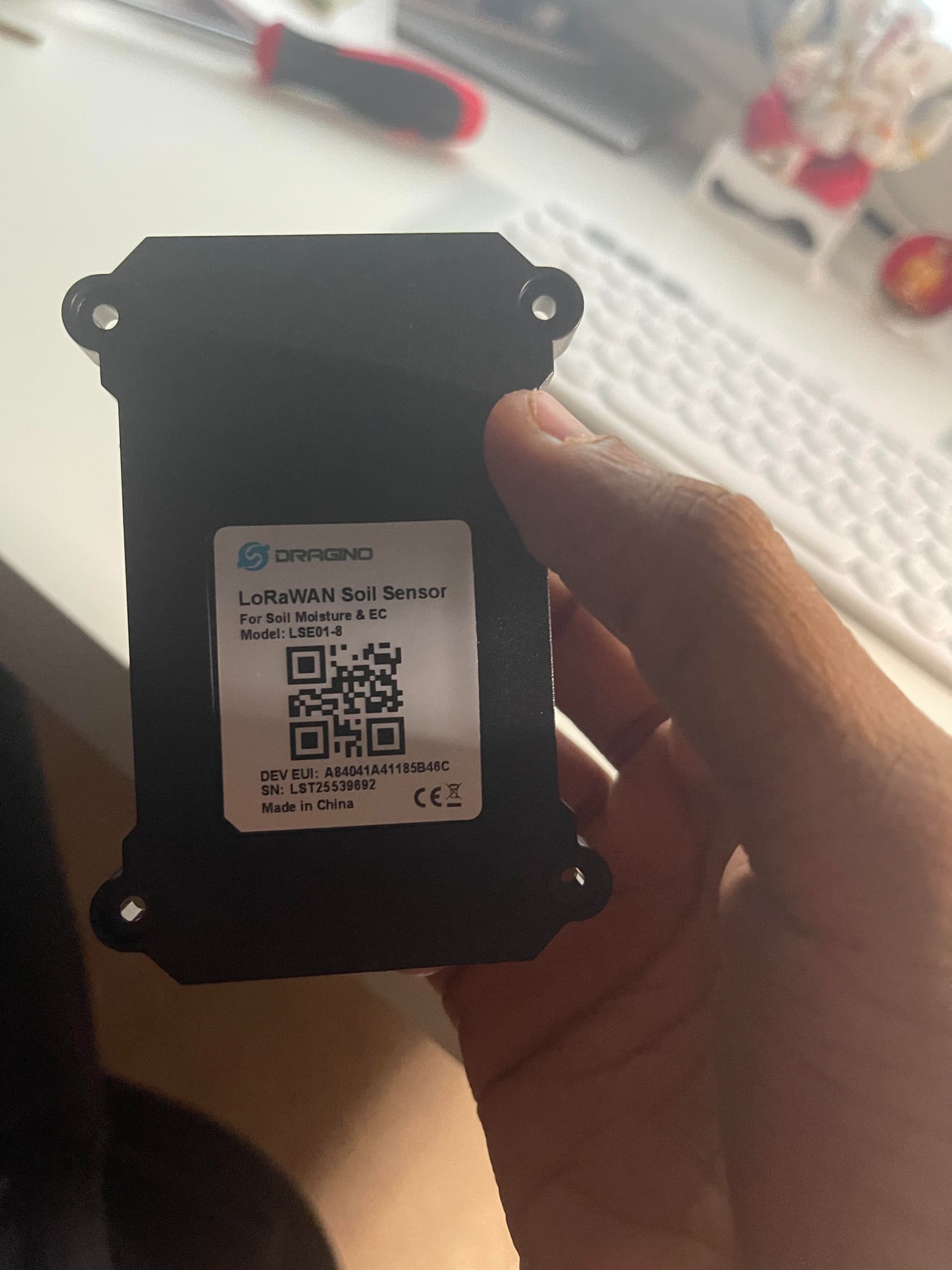

Hello everyone¡ Im a student how bougth a Dragino Lse01 Soil Tester and a LG01P Gateway. I`ve got connect the Gateway in the TTN page and its seems to be fine, i have request, the problem is… When i try to connect the soil measurer, it do nothing.
I tried two ways, automaticly and manually. To make sure all the data are correct un LSE01 i did a ttl connexion, and i get the AppEUI, DevEUI, AppKey. Also i have updated the device to the 1.1.4 firmware version.
But when i create the aplication in ttn it says, “Not activity yet”.
please, someone can bring me some light??
All i read on the forums its according whith what im doing, other thing i thougth is the Sensor its broken…
