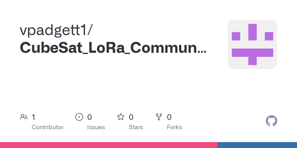

Link to what my friend is doing

This is LoRa to LoRa aka Point 2 Point - which is fine, there is no encryption, it’s all simple scripts, you CAN NOT do this with an LPS8N as it’s firmware is based on 8 receivers, not one. And P2P is off-topic for this forum.
