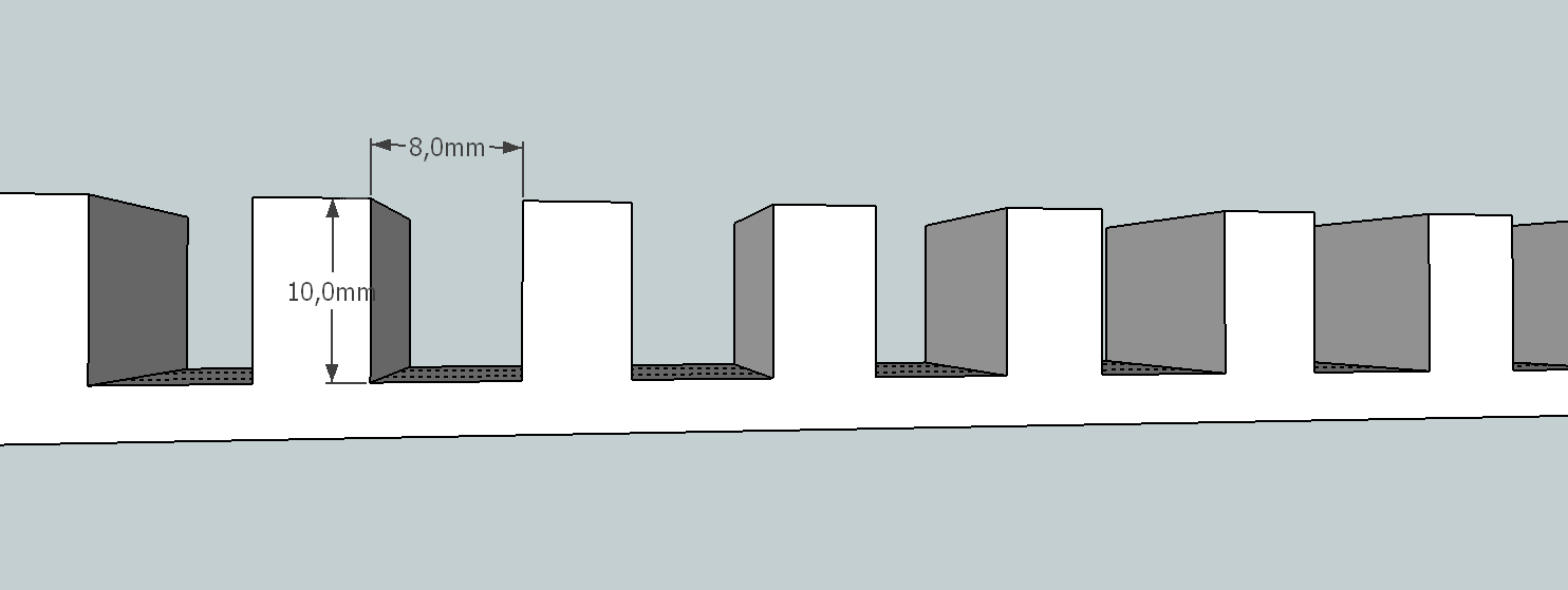

Have a look at this topic Conting bees with IR light barrier:
I have used two QRE1113 IR sensors to detect (honey) bees flying in or out the hive!
