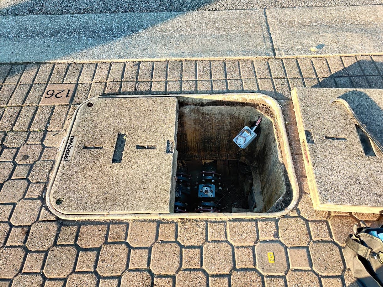

Greetings. We have been monitoring our snowmelt system with home-brewed sensors for a few years now. It’s time to retire the hardware and replace it with a more robust, commercially available option. I’m seeking advice from you. What are your suggestions?
TTN compatible Lora
Temperature probe on a cable for inserting into sidewalk
Long battery life (all winter), and easily battery replacement/recharge.
IP67 waterproof.
