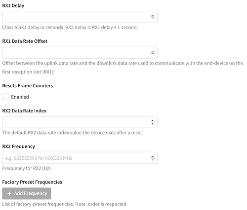

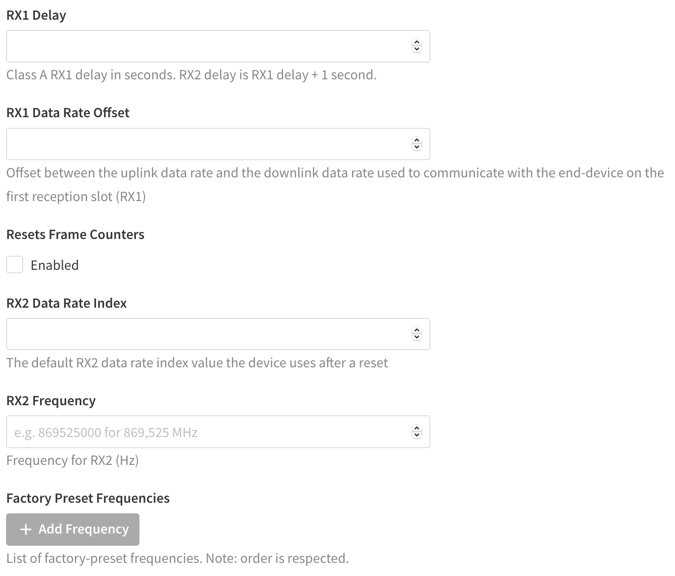

The assumption in The Things Stack is that those who use ABP devices, will tell the Network Server what settings those ABP devices use. These settings must be filled in the “Advanced settings” section of the “Network layer settings” when registering a device.

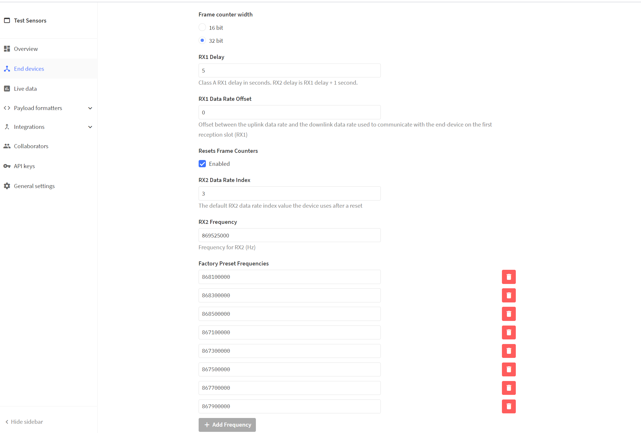

I was able to get a TinyLora node to receive on all channels by adding the several frequencies in the network layer advanced section. This only worked with a newly created device (modifying an existing one didn’t work for me).

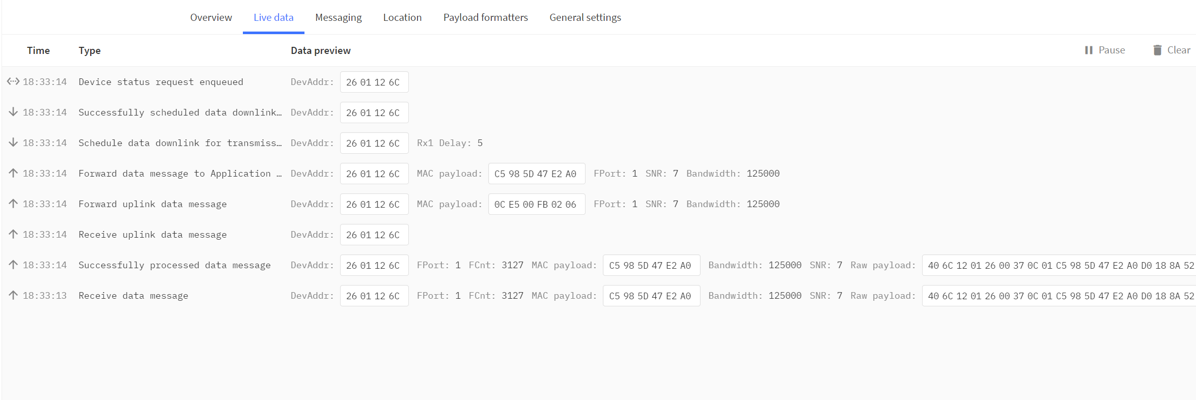

Below you can see the response in the application live view. There are no new channel requests any-more & data is received on all 8 channels. There is still a schedule for a data downlink transmission. Not sure if this can be switched off (as the device cannot receive anything).

@htdvisser For the sake of verification I created network layer advanced settings.
Can you please confirm or comment these? They are meant for a ABP device that works on V2 and that shall be migrated to V3.

I have now the following settings implemented (node with TinyLora). As mentioned this only works with a new device. Changing settings after device creation didn’t have any effect.
This gives the following response.
There are no set-up requests anymore and the device is reportig on all 8 channels. So I am happy with the result.

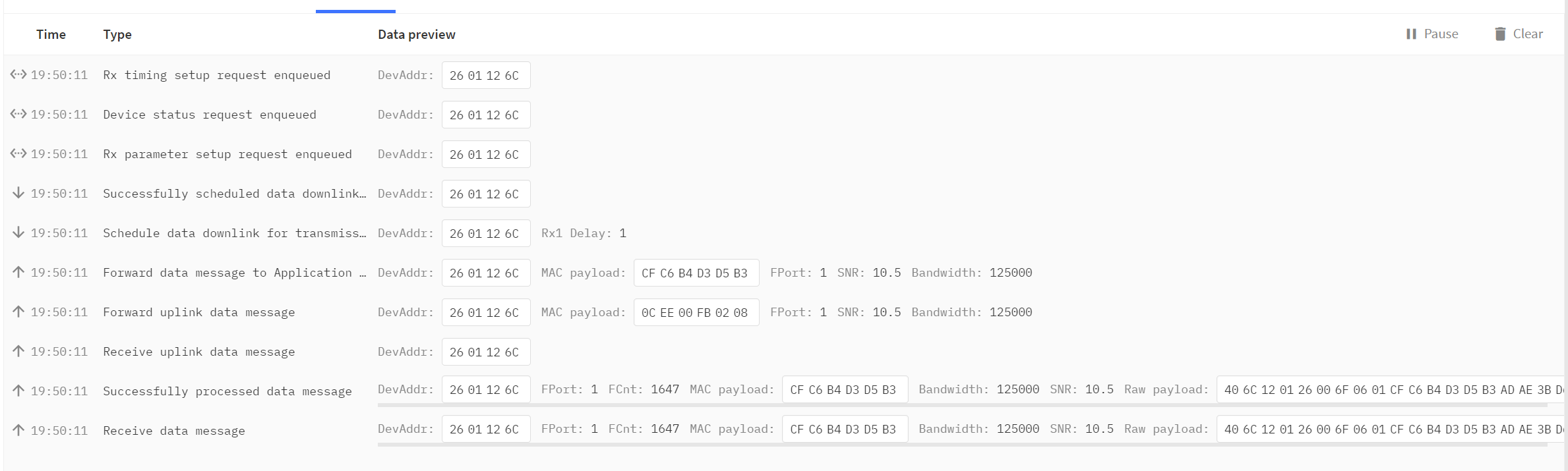

I believe that with a 1 second RX1 delay the application will sent a downlink request to change to 5 seconds. At least that happened when I didn’t specify the RX1 value at all.
As this is for TinyLora which cannot receive/respond to the request I did change to 5 and the request was not generated (resulting in less unneeded trafic). Not sure if this will also be the case when I specifically set it to 1 (will try-out in future)
For ABP devices that can receive downlinks 1 second for RX1 is probably the way to go.

In my case the network keeps sending downlink messages. I updated network settings but I see no change unfortionately.
