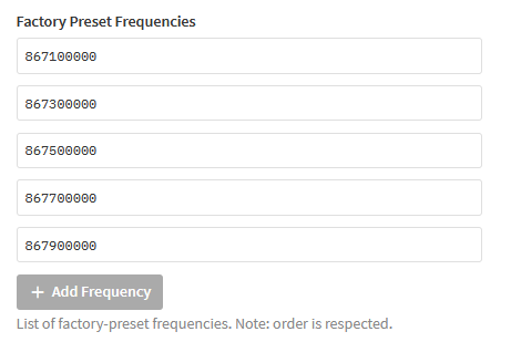

In the advanced settings you are able to add programmed channels. You could try adding the 5 additional channels in those settings.
MAC 1.0.1 is probably the best option.
Added these in the network layer advanced settings. Still same results. The standard 8 channels should work anyway without this?
Set MAC to 1.0.1
channels
The 8 uplink channels will be received without any issue, I was hoping (without looking at any code) that you telling the backend those channels are programmed would make it stop trying to push them with MAC commands.

Check if adding the additional frequencies in the advanced network layer settings helps. I had a similar issue with a node and adding them resolved it. (In the application I saw messages concerning uplink frequencies)

These downlinks are likely generated because the MAC state of the end device (as far as the Network Server knows) doesn’t match the desired MAC state. If you register an ABP device with the default settings, the NS thinks that there are only 3 channels configured, and will try to configure the other 5. It will think the RX delay is 1 second, and will try to change that to 5. Depending on the frequency plan, it will also try to reconfigure the RX2 data rate from SF12 (the LoRaWAN default) to SF9 (the default on TTN).
LoRaWAN-compliant devices will send a response to acknowledge that they processed the MAC commands.
This actually makes sense. If you didn’t tell the Network Server that your device uses those channels, it will not consider your device when matching the uplink, and will try to configure those channels with a downlink MAC command.
