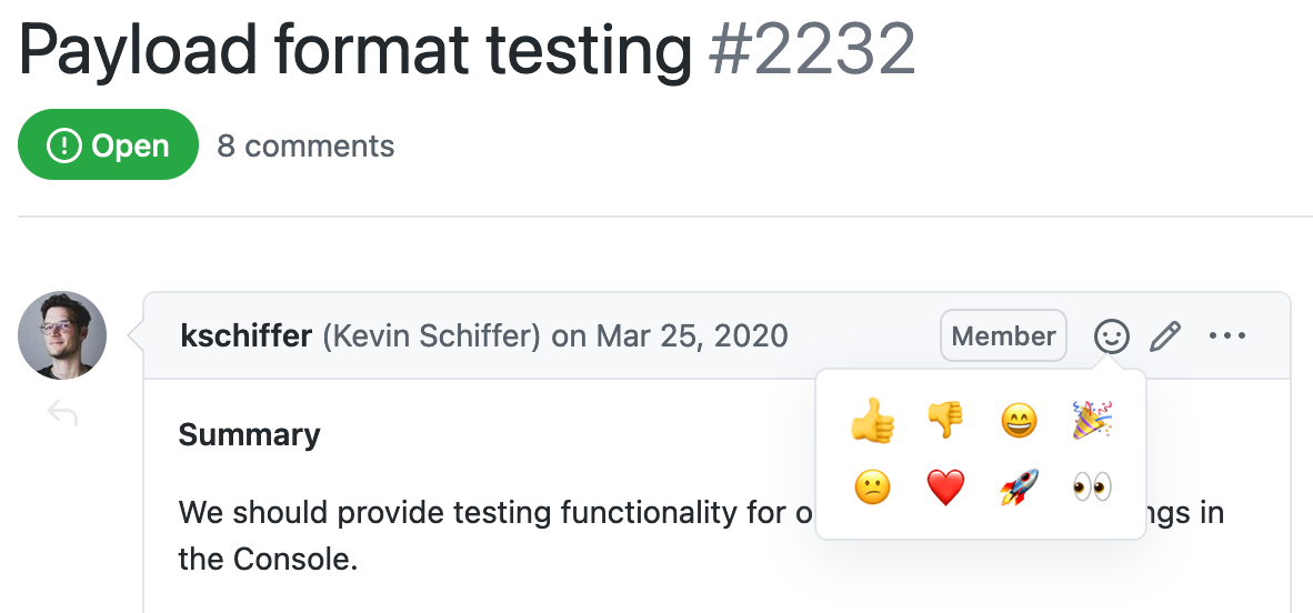

We have some open issues related to this on GitHub:
If this is important to you, you can add a :+1: on those issues. The team uses those :+1:'s to prioritize what we’re working on. Also, if you’re interested in contributing this feature, please leave a comment on the GitHub issue.
Screen Shot 2021-02-03 at 11.45.49
