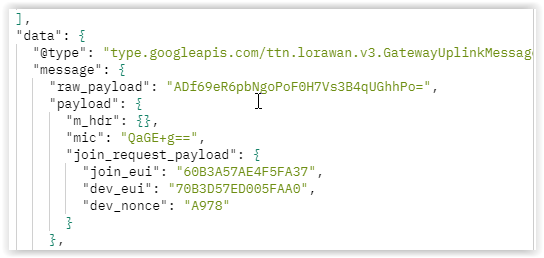

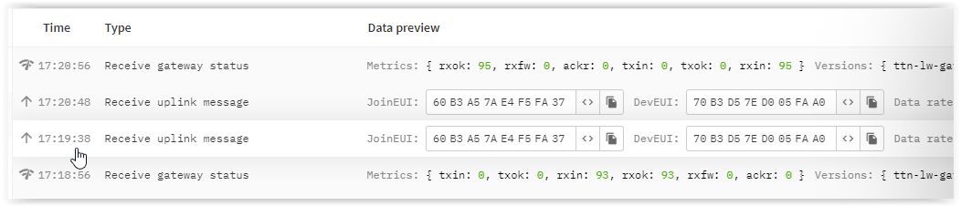

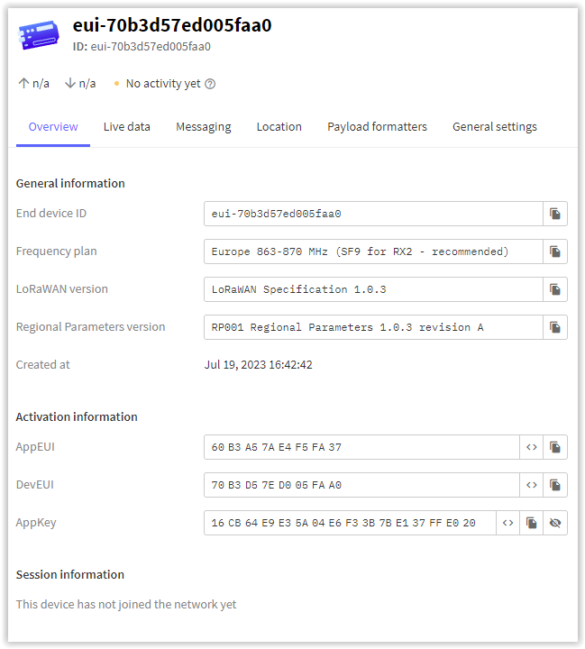

Hi.
Gateway console shows received uplink join messages, I can successfully decode message payload using AppKey so all keys seem to be setup correctly on the node.
The application console doesn’t show any received messages.
What am I doing wrong?
I’m using lnlp/LMIC-node on ttgo lora32.
https://lorawan-packet-decoder-0ta6puiniaut.runkit.sh/?data=ADf69eR6pbNgoPoF0H7Vs3B4qUGhhPo%3D&nwkskey=&appskey=16CB64E9E35A04E6F33B7BE137FFE020
Screen Shot 07-19-23 at 05.55 PM
Screen Shot 07-19-23 at 05.22 PM
You are not showing the frequencies used for the joins. For EU868 one of the frequencies 868.1, 868.3 or 868.5 MHz should be used. Is the gateway receiving the joins on those frequencies according to the console?

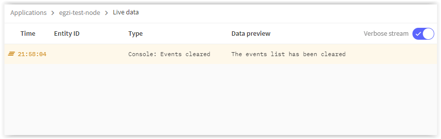

I think the application live data view in the console should show something about the result of the join request with the join server, you may need to enable ‘verbose stream’ for that.

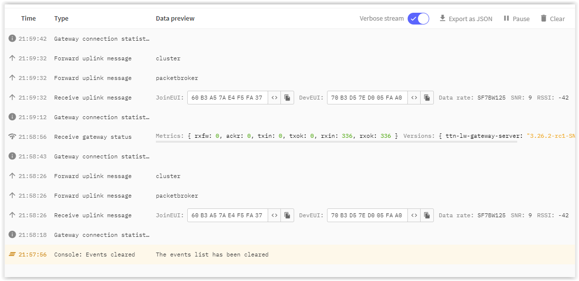

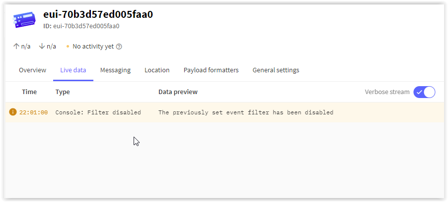

After receiving multiple join packets this is what the consoles look like, after 18 packets application and device consoles are still empty:
Screen Shot 07-19-23 at 10.06 PM 001
You are probably using a single channel packet forwarder and not a LoRaWAN compatible gateway. LoRaWAN with TTN only works with a 8 channel LoRaWAN compliant gateway.
Yes I am using single channel gateway, I know about limitations of this approach, but the packet is received, how does TTN know it’s single channel, why doesn’t it go through?
TTN knows and because single channels packet forwarders disrupt service for other users they should not be used. Please disconnect it from TTN now!
