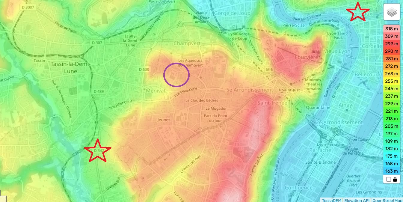

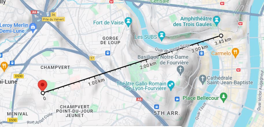

@jaguarg sadly I think where you are to the western side of the raised ground in the area precluded hitting the ‘LYON’ gw which is settled well down in the valley between the rivers in the area around Rue Terme and the Hotel de Ville area. A combination of woodland? building clutter and the extended high ground towards you away from the valley escarpment means chance of coverage from there is poor if not impossible. Similarly, I think the slightly closer gw down in the direction of Frencheville is low set also and therefore high probability that it is masked by the high ground to the west of Jeunet even without any building clutter.
Best option is move or extend the Community by placing your own GW :slight_smile: :+1:
Also I suspect the SW Gw is not always online - TTN Map may show gw’s for weeks after last seen where TTNMapper likely drops after a few days… it shows on former but not the latter.

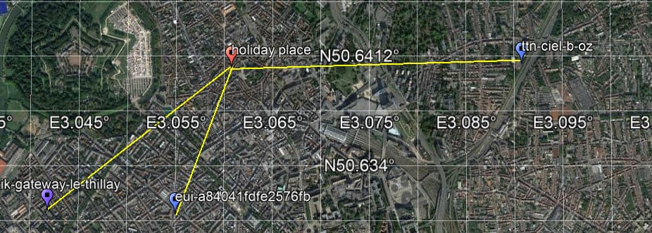

For the holiday home it is more tricky. I want to monitor presence, temperature, door and windows open/close. There I don’t have internet access. That is why I was keen to try connection to an available gateway. My holiday place is located here lat 50.640450948017886, lng 3.06072599084507.

their are 3 gateways in that area
1.14, 1.69 and 2.13

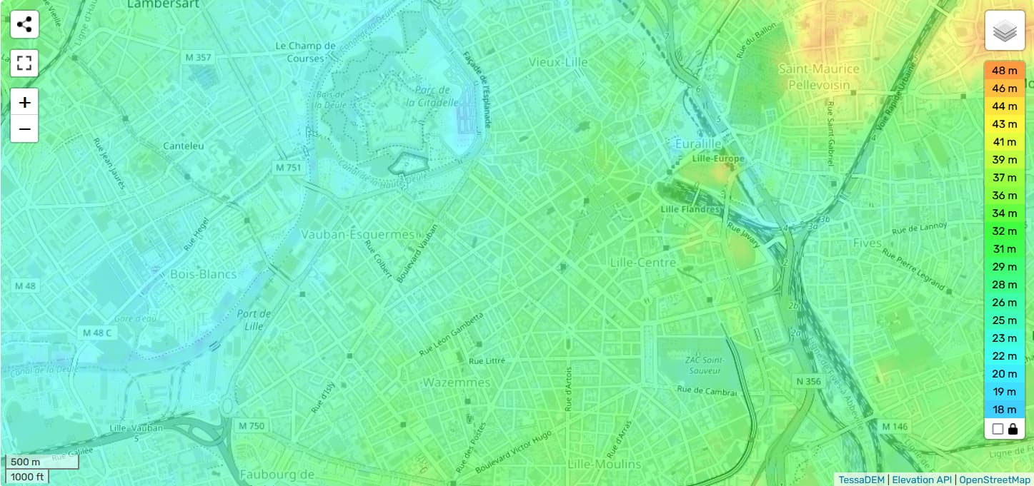

terrain seems fairly flat again you will need to test to see if you have coverage

@jaguarg indeed very flat in relative terms - maybe 8-10m range of height variance so if sensor at reasonable height (not on the ground) and GW’s also reasonably high then it will be down to the scale of any building clutter and absorbers.
