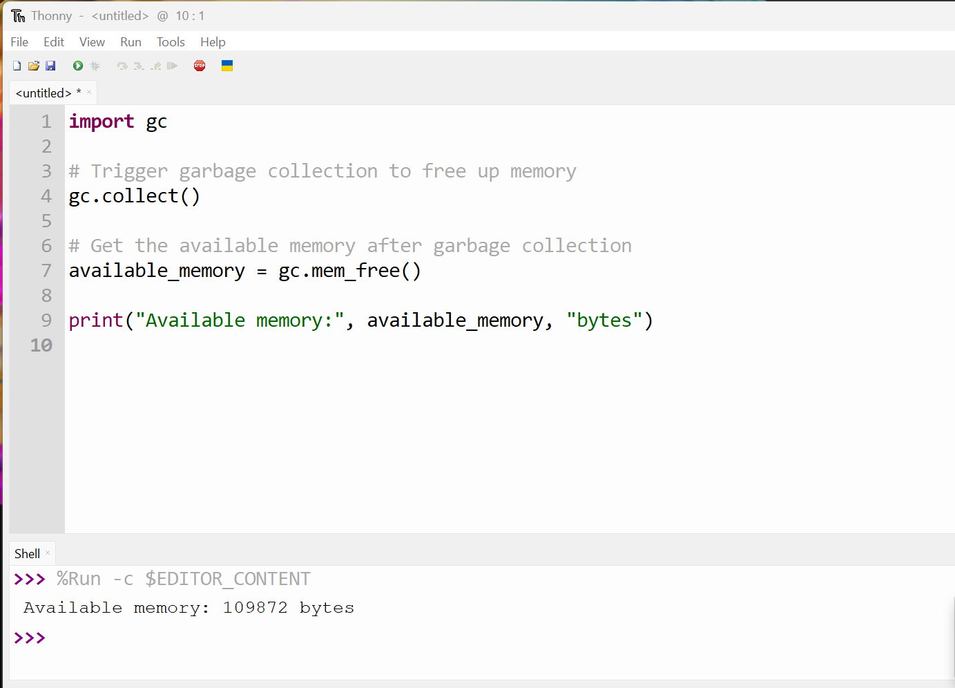

It is like 107 kilobytes
IIRC the doit only has 11k left so this looks like it might work if sensor code doesn’t add much. It can’t hurt to try. You’ll just get a memory allocation failure if it runs out.
You could add the gc.mem_free() in testTTN.py to see what’s left after the code has loaded.
If you don’t need logging you can remove it but when I tried that the doit still ran out of memory. You should remove logging anyway when testing is complete because it is writing to the filesystem and so flash will wear out eventually.
