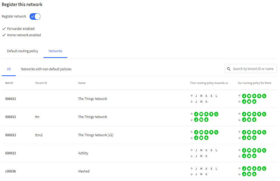

I think I have set the Packetbroker settings fully public and open. See attachment.
Also the gateway settings are set to public. But the gateway still doesn’t show up on the map on the frontpage of TheThingsNetwork.org.
Gateway is v3, not using the community server, but the free cloud version.

The map on the front page of TheThingsNetwork.org currently only shows gateways connected to The Things Network (V2) or The Things Stack Community Edition (V3). It does not (yet) show gateways that can be used through Packet Broker.
