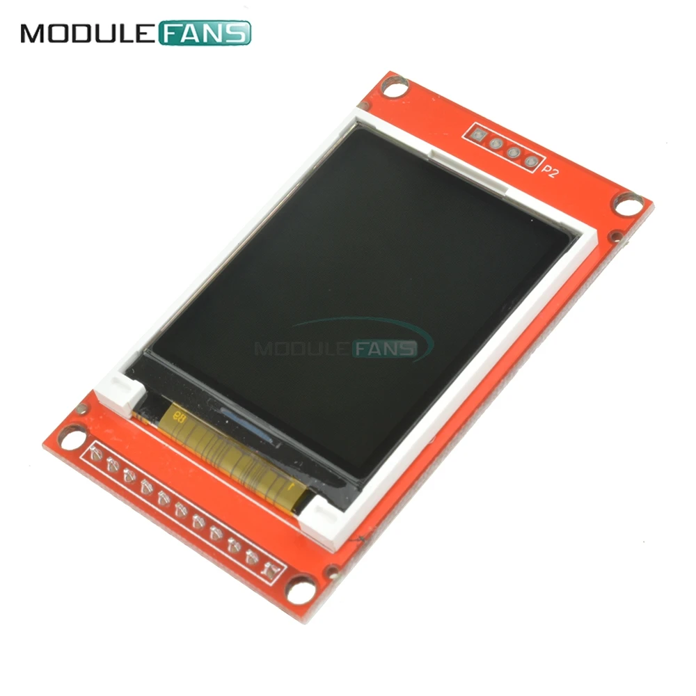

tnx . it is TFT … no LCD … power consumption is big
Where can we find the blue pcb one ?
I have the up left one, but too small for most bin fingered people
have to find it in my archives somewhere.
in fact the wheel is a rotary encoder + if you push a switch, very handy (I think it was expensive

I found a good quality one
http://www.chip45.com/products/dogm128w-6_lcd_display_modul_grafik_128x64_pixel_seriell_spi.php

_there is a tool named startdog_V43 to get an idea how that (expensive with backpanel!) display looks.
US $7.44 - http://www.ebay.com/itm/302285955198?
(just bought one myself to test for another project)

And Yes this LCD screen is excellent. We will use it also
