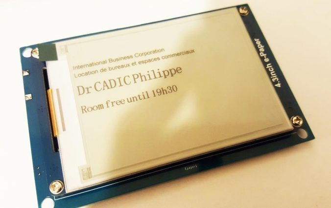

so why not use a low energy e-paper display in your pager ? (yes I know they are still a bit expensive )

Well LCD is not draining too much power compared to epaper

for some reasons I feel LCD will me more open to not-yet-discovered extentions

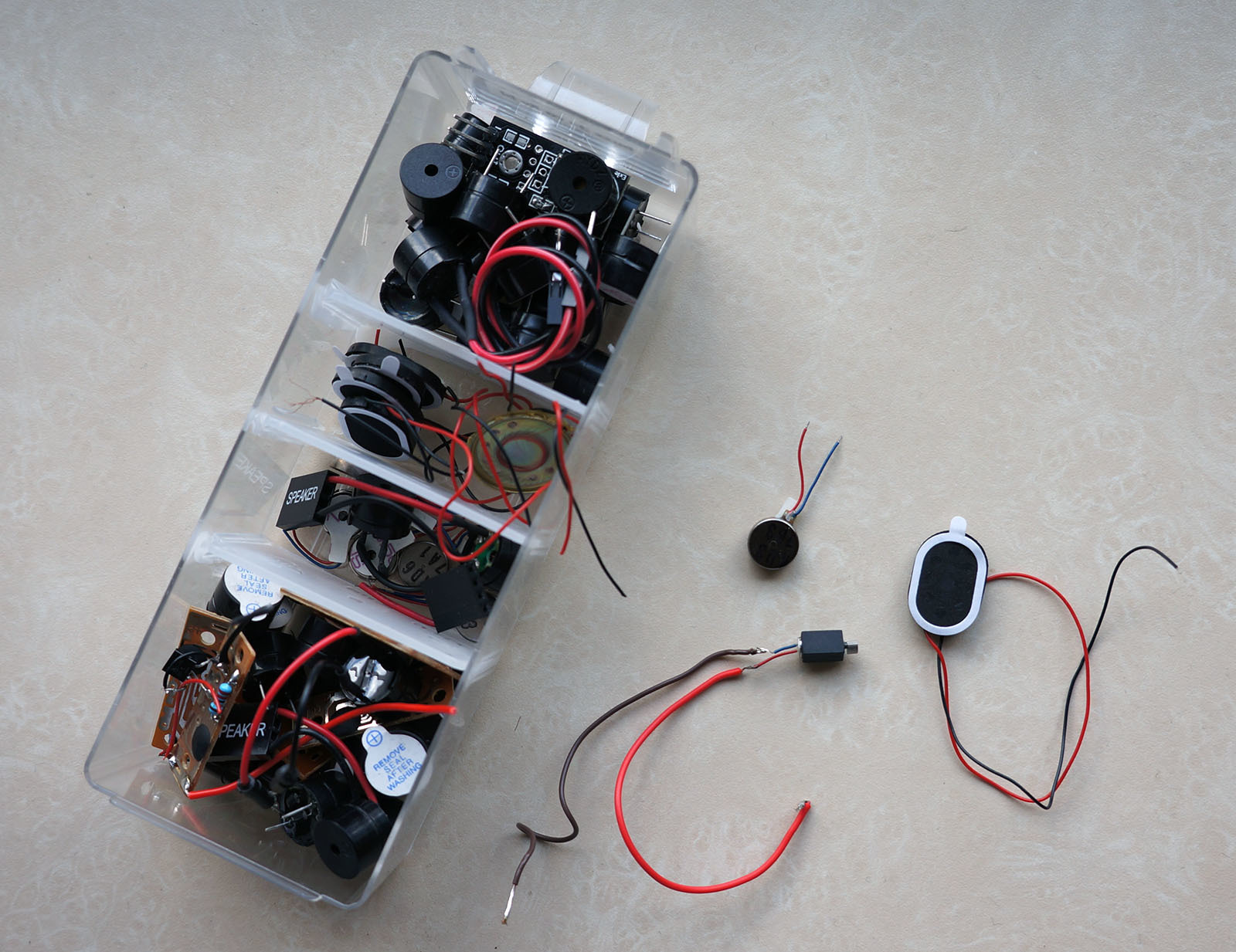

carefull, some of those vibrationmotors can use 100-110 mA and without a switching transistor you blowup GPIO port
