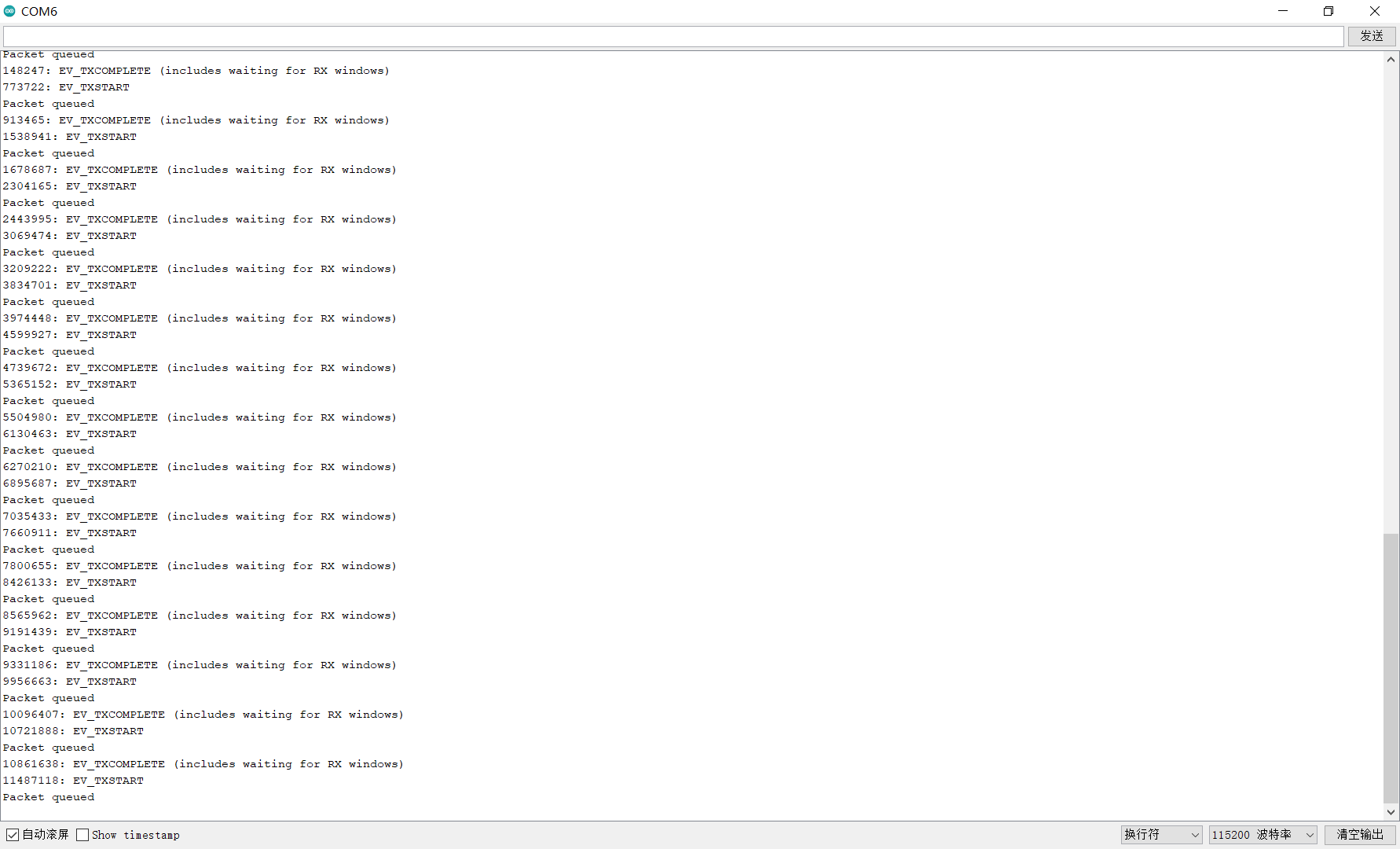

I tried the settings and send packets, but the gateway can not receive them.
Any way to debug, for example, see the detail of the sent packet including content and frequency?
What settings, what region, what program, what board (etc., etc., etc.)?
We don’t have crystal balls on the forum so you will have to provide detailed information relevant for your case. Don’t make other users have to ask and guess for information that you need to provide yourself.
What gateway, what (region) settings (etc.)?
What have you tried exactly?
Read the LMIC documentation for how to enable debugging.

Please do not post images of code, logs or text.
