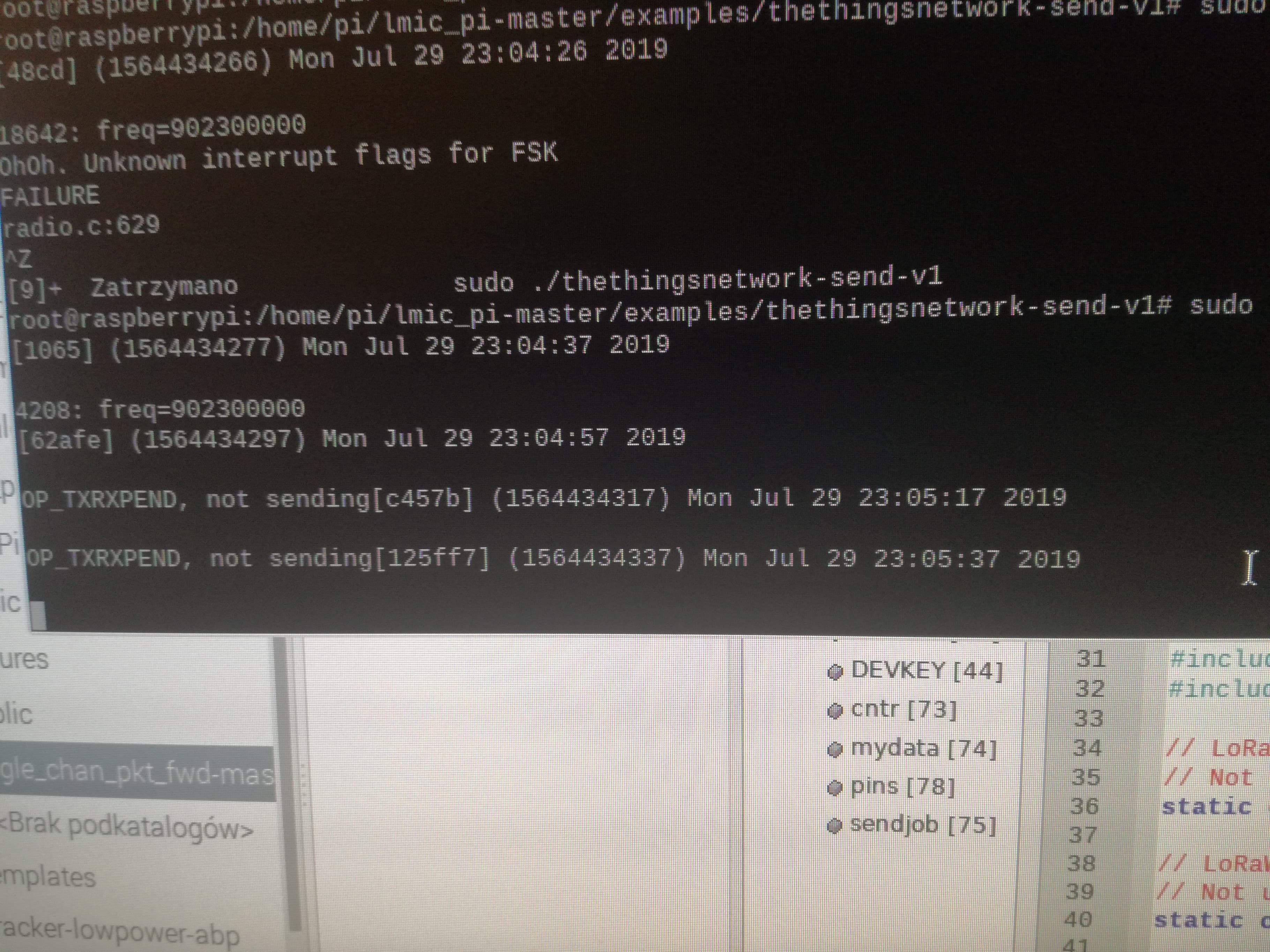

What is wrong?received_511304946308918 chrome
Ctrl-Z is suspend, use Ctrl-C to kill something. Suspending an instance may have left it in the background fighting the new one for ownership of the radio.
You need to debug the flags issue; and figure out why FSK was involved at all.
The LMiC stack which you seem to be using some variation of will not stage new data for sending if it still has a send / receive cycle in progress; you’ll need to understand what is going on overall.

I noticed that I’m using the wrong frequency.

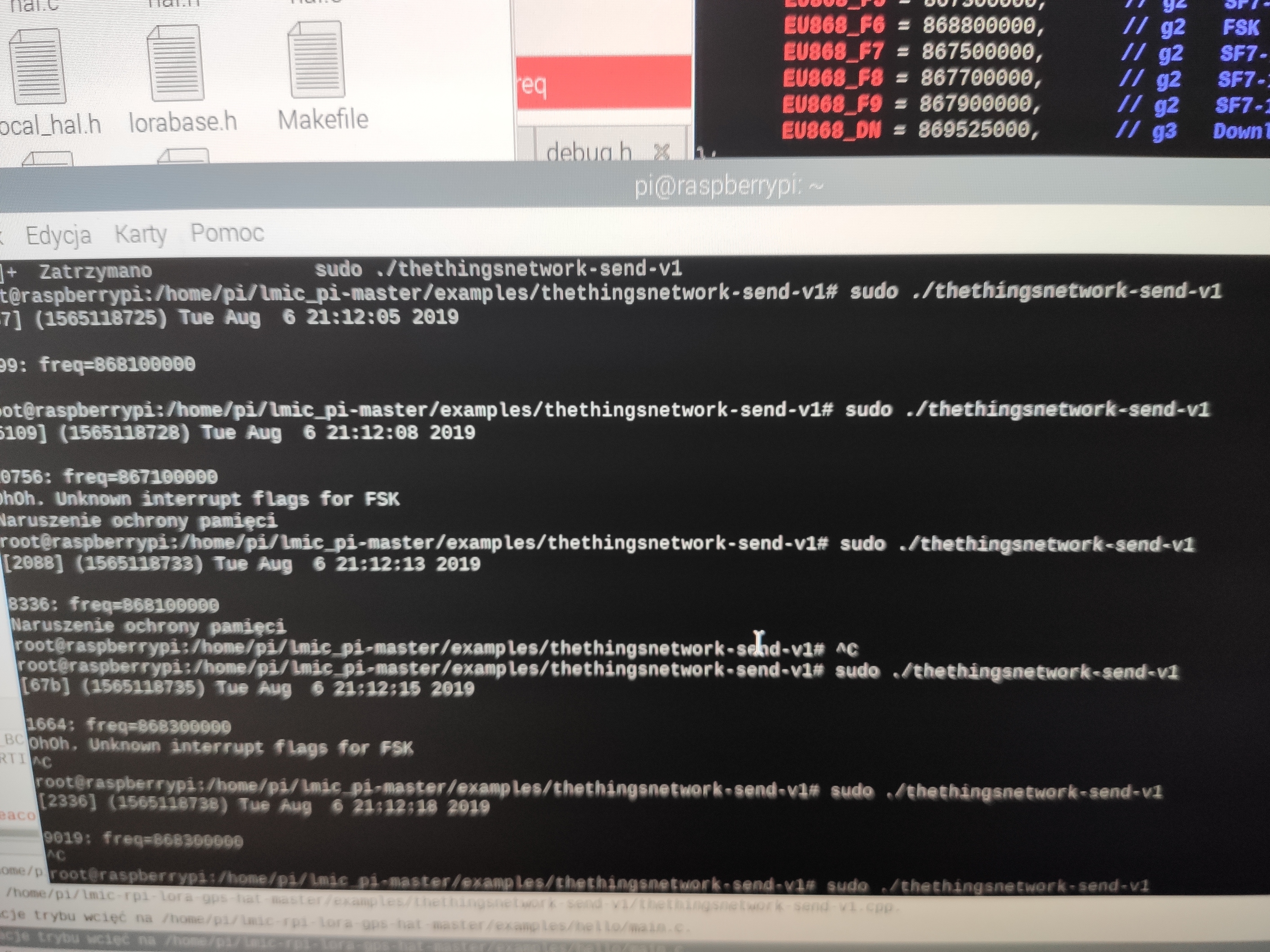

I change 902 Mhz to 868.1 Mhz. but now I have errors.15651189185272556634712510031606
15651191483565331261070850588408
15651191743454630145593469774322

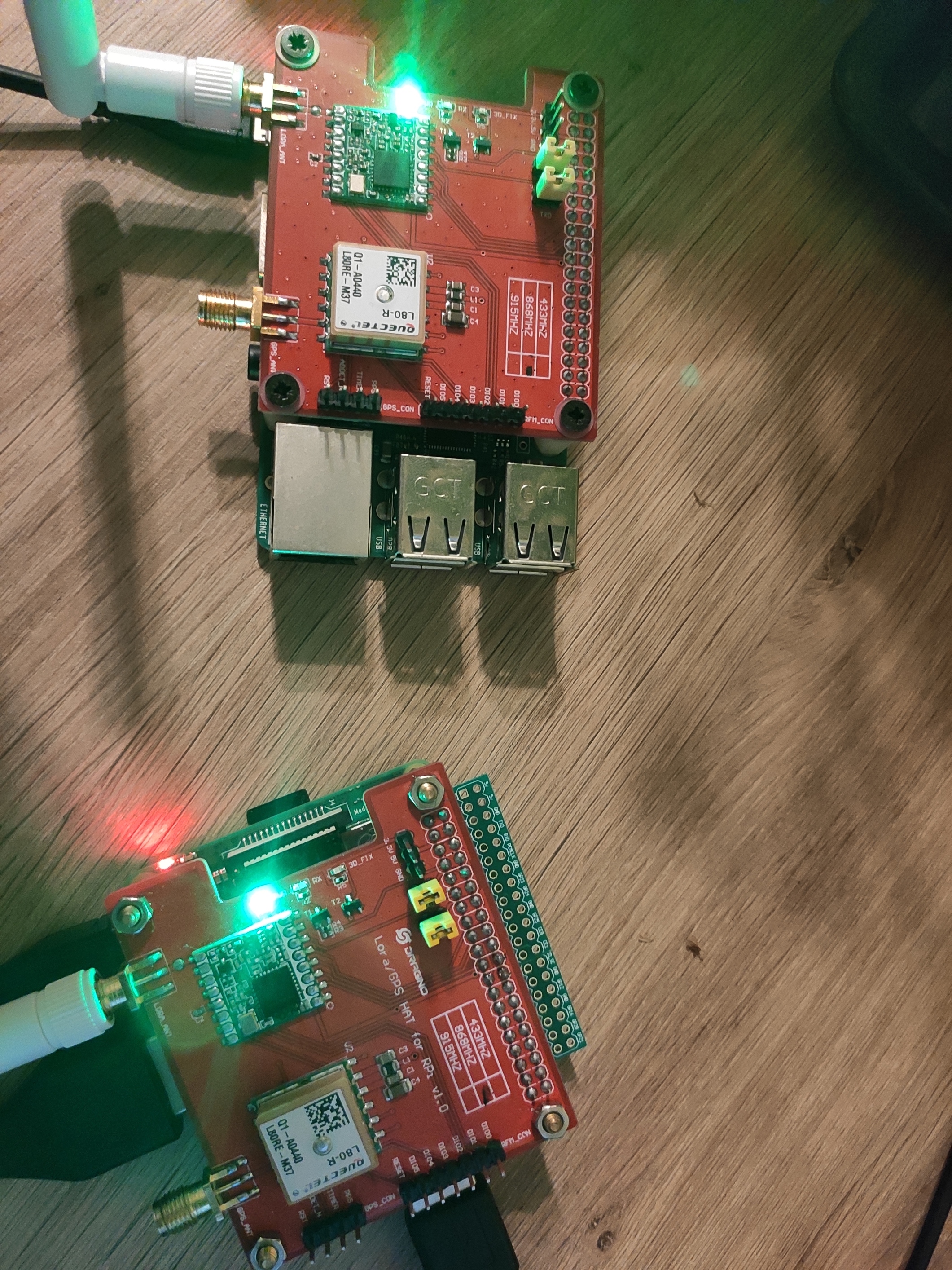

Rpi 3b is gateway, rpi 3a is node.

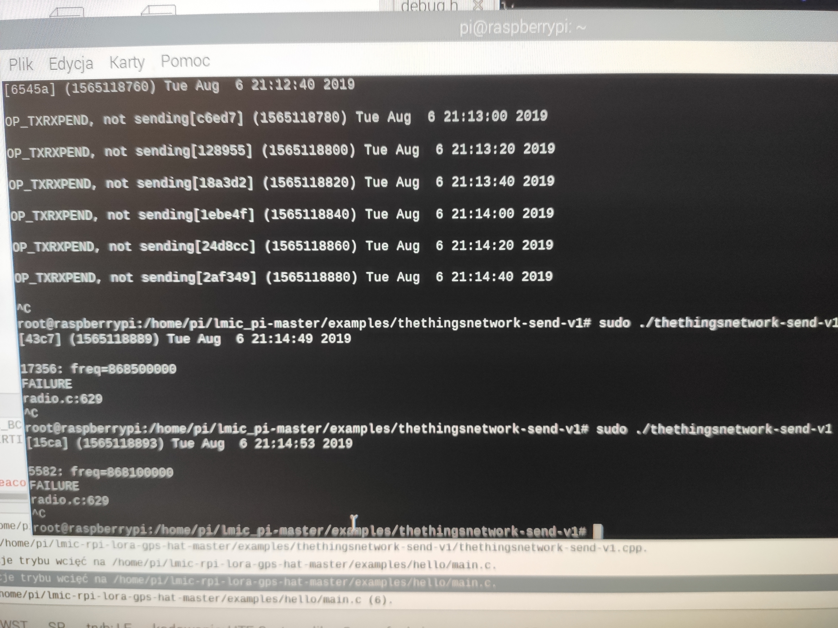

How i can debug the flags?
Trace back through the code generating the messages.
Print out what is actually read from the chip, compare it to the data sheet
Consult with the author of the raspberry pi port you are using.

This may well indicate and SPI wiring issue.
The mention of FSK mode in the earlier posting also suggest misconfiguration, while LoRa chips do support FSK modes, TTN doesn’t generally utilize such.

Yes, actually because I wasn’t able to make it run. I build my own gateway.
The issue now is that the other pi supply node conncets to the gateway with no issues, whereas dragino is not connecting at all.

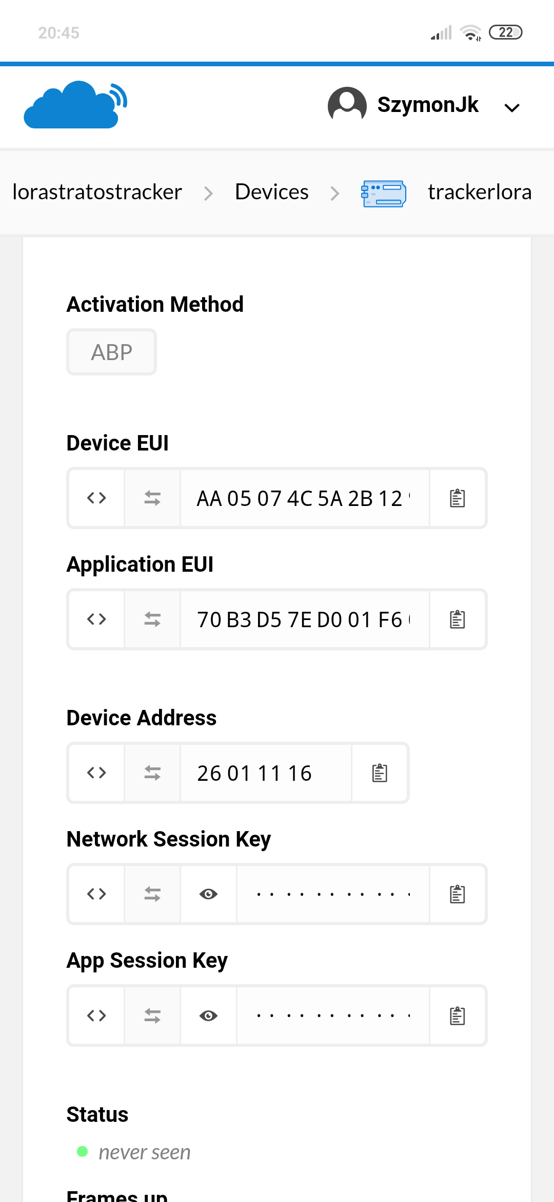

If one node is taking longer to get started but eventually does, that often points to illicit re-use of the join nonce (if it’s the join accept that is taking a while) or illicit rollback of the frame counter, as within a given set of credentials from ABP or assigned by OTAA, any decrease in the frame counter is viewed as an attempted attack by someone who recorded old packets and is trying to play them back. Packets won’t be decoded until the frame counter reaches a larger value than previously used, or until you reset that on the server.
@cslorabox just re tested everything and I have checked the gateway traffic and there is nothing. No join. No messages.

Start by moving the node at least 10 feet from the gateway. If a node is sitting too close to a gateway its transmissions are much too strong to be received correctly.
@kersing unfortunately this did not help.

There definitely needs to be “gateway traffic” - if the network isn’t hearing the node attempt to join, no join accept will be generated.
You need to figure out why the node isn’t being received when another apparently is.
Perhaps it is transmitting on the wrong frequencies, or perhaps the hardware has become damaged.
