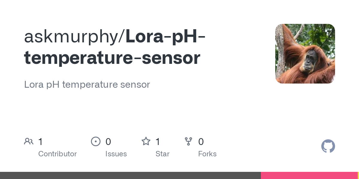

I have made another solution, different hardware:
Maybe you can do something with that?
