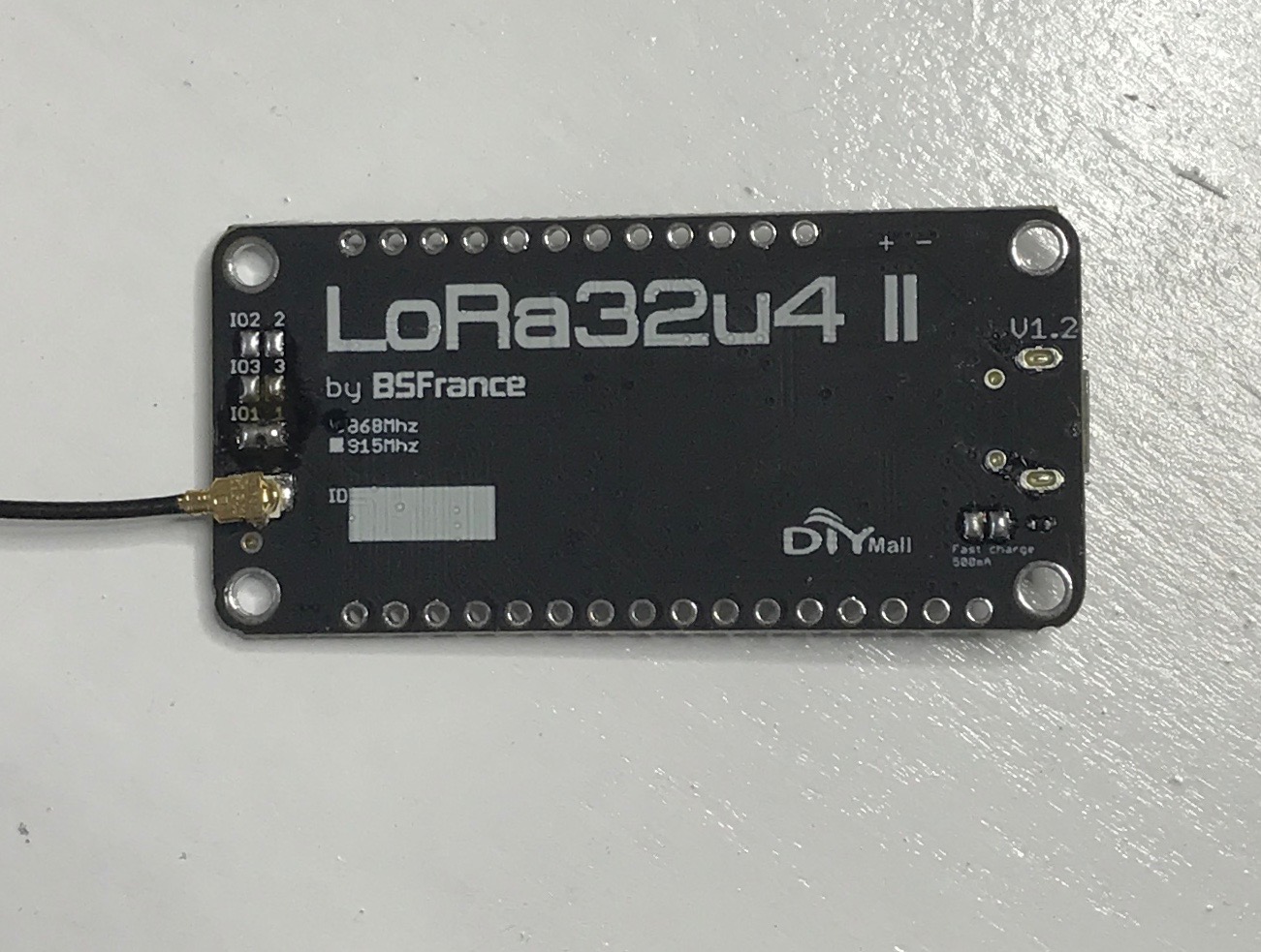

Connect and configure DIO1 of the radio to a pin, it signals tx complete I believe
Thanks. I soldered the DIO1 to D1 and now the damn thing works!
For reference, DIO1 is located on the back side of the board.
Here’s the LMIC pin mapping:
.nss = 8,
.rxtx = LMIC_UNUSED_PIN,
.rst = 4,
.dio = {7, 1, 2},
Ha! didn’t know that
Just for future reference, Matthijs has documented the required pins quite nicely at https://github.com/matthijskooijman/arduino-lmic#dio-pins
As DI02 is not connected (and does not need to) ![]()

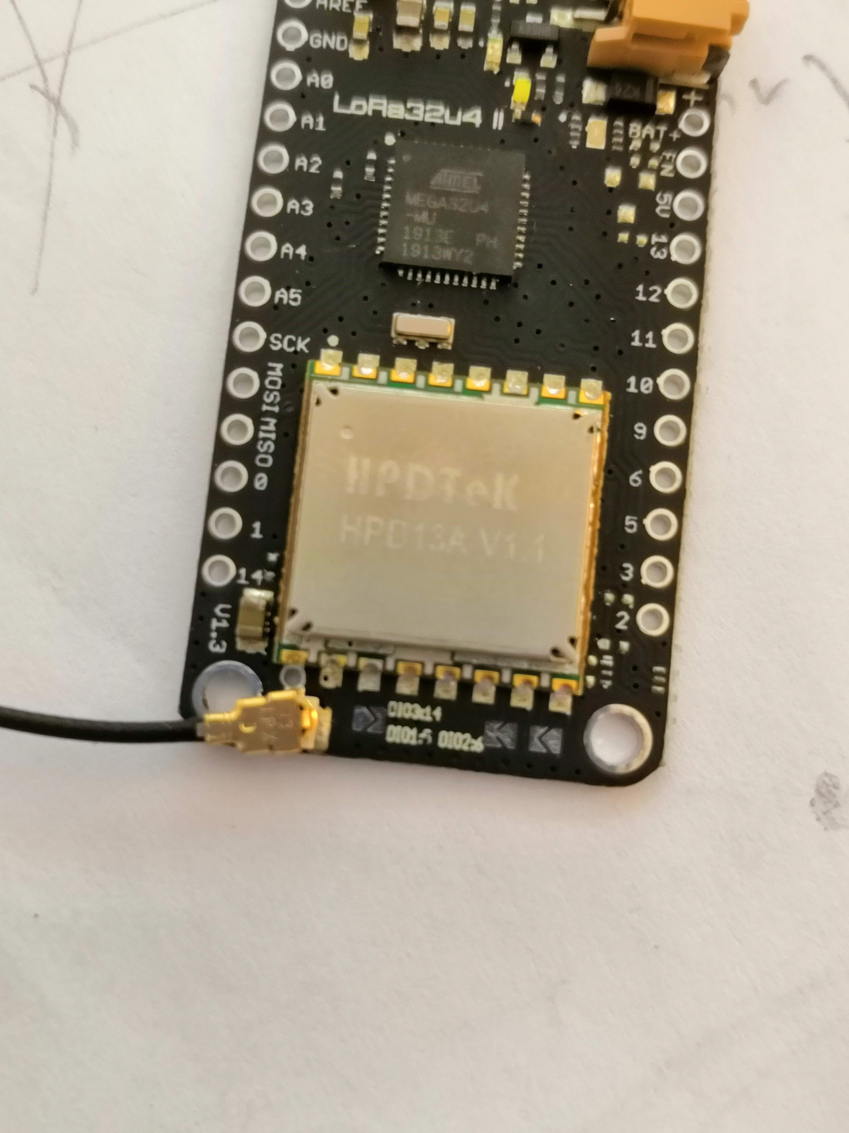

Same problem here with board version 1.3.
According to BSFrance support : there is no need to solder, because DIO1 is closed by default.
My pin mapping :
.nss = 8,
.rst = 4,
.dio = {/dio0/ 7, /dio1/ 1, /dio2/ LMIC_UNUSED_PIN}
