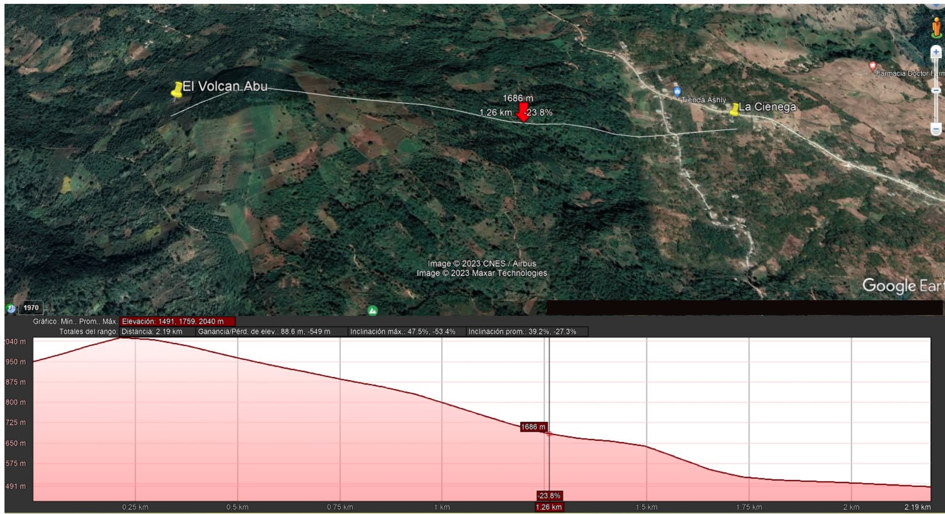

In specific I am interested in having a couple of end nodes with sensors on the coffee field and send the data to my gateway which is located at a distance of roughly 3 km from the field. The issue is that there is not direct line of sight between the lora gateway and the field, in fact there is a small volcano hill right in between both points.
You can take a look to what I mean with the help of the following picture:

Its not entirely clear what is where, can you clarify where the gateway is and where the field is ?

@LoRaTracker sorry, yes I forgot to specify about the points.
On the white line drawn over the google maps view:
-The coffee field is found on the left end point, here is where I want to install my sensing nodes.
-The gateway is found on the other extreme of the line, on the right side.
As you can see from the bottom graph, there is that small hill in between both points that limits the visibility from each other.
@descartes , thanks for your feedback. Well, having the gateway on the coffee site is a bit of a difficult situation. Over there we have no access to electricity, therefore my idea was to use only the battery powered devices on the field and the gateway on the other end where I can connect to internet and have a constant electricity supply.
