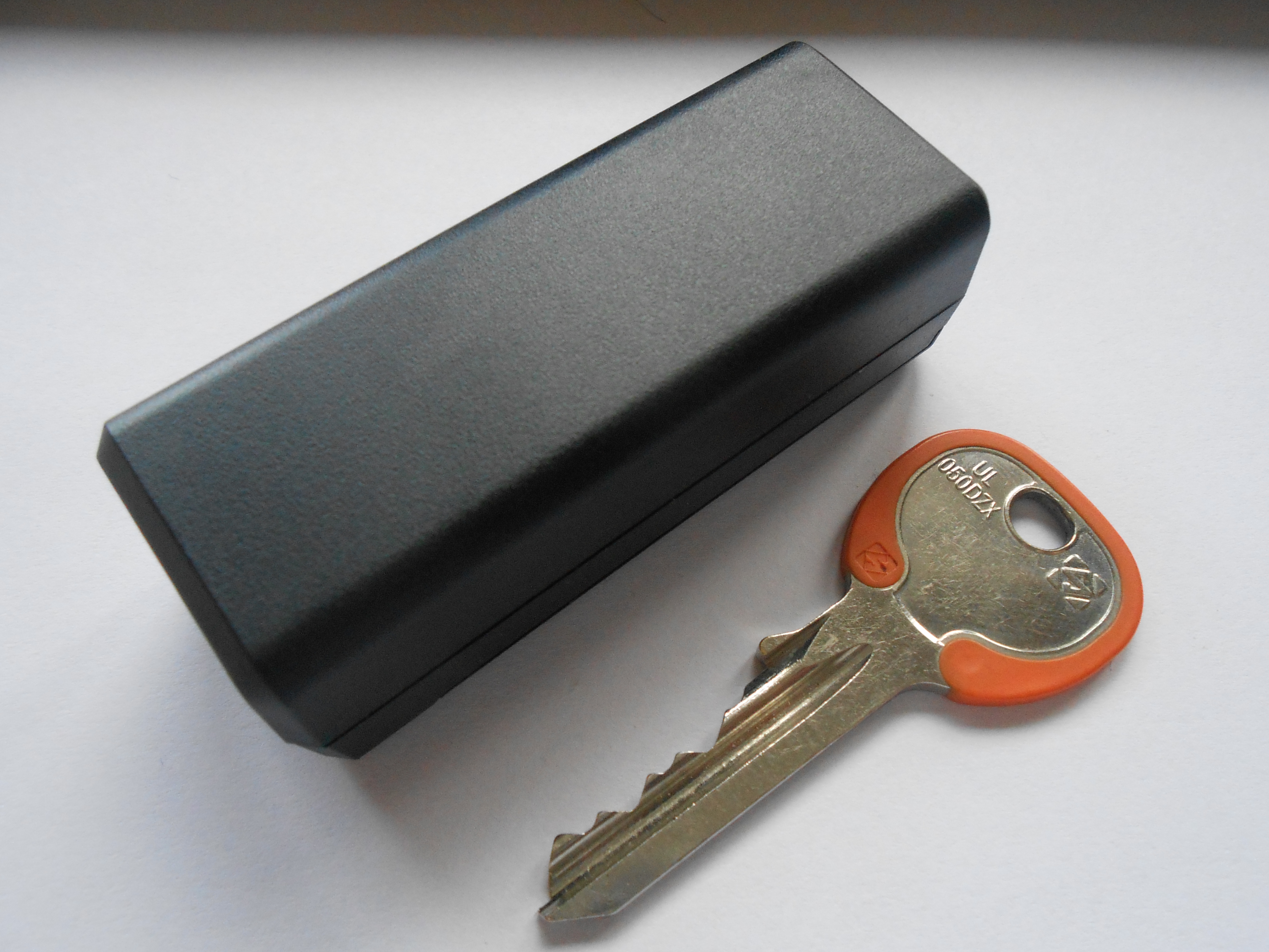

If your going on a public network that supports geolocation (eg KPN) you can also simply use a LoraWAN accelerometer which does uplinks while moving. The network calculates the location based on TDOA. Altough not as accurate as GPS, its very battery and cost efficient.
Link to the product:

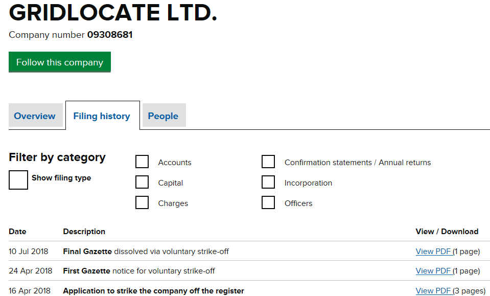

Just a heads up, as the last forum posts have resurrected a thread 11months old, that the company referenced earlier - Geolocate was dissolved back in July per records at Companies House. The website is still ‘alive’ and listed as © Geolocate Ltd but may be that having prepaid (say annual or bi-annual) hosting charges & domain fees that the site has continued after dissolution as a Zombie and should therefore be treated as a zombie/orphaned site esp wrt any ‘shop’ or buy sensor requests (which call out other 3rd party products). The was an earlier company of the same name also dissolved - back in 2015.
just saying…as it may be someone is monitoring emails/info requests etc. to provide follow up, in which case perhaps they can update all on forum and put back on a legal footing… :wink:
https://beta.companieshouse.gov.uk/search?q=gridlocate+ltd
