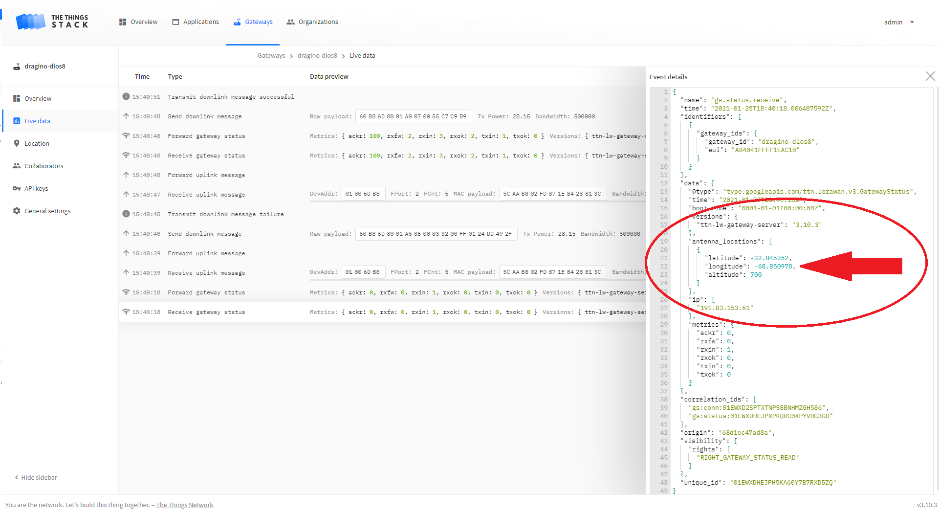

Hello, I want to know if it is possible to access through MQTT the data that the keep alive of the gateway sends, I am interested in the gps data, since it is a mobile gateway.

I am simply asking how to extract the metadata of the gateway from the stack of things, I do not see that it is breaking any rules here
There are definitely use cases for mobile gateways. In fact, we’re already seeing production deployments with gateways on ships, trains and even satellites. We have an open issue about ignoring mobile gateways in the ADR algorithm: Data pushed by mobile gateways should be excluded from the ADR algorithm · Issue #545 · TheThingsNetwork/lorawan-stack · GitHub, and with that we don’t have to worry so much about mobile gateways potentially messing with network performance.
To answer the original question: If your gateway uses an authenticated connection and sends location updates in status messages, The Things Stack will store the latest location in the database. Furthermore, if you set the location of your gateway to “public”, it will be added to the metadata of each uplink message.
You can not use MQTT to subscribe to location updates specifically.
