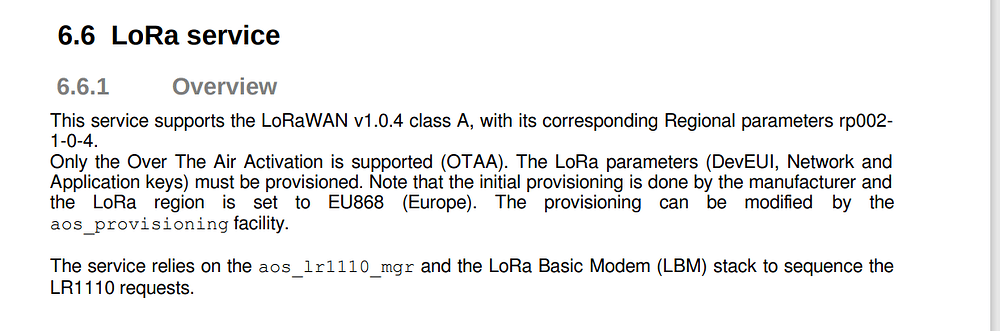

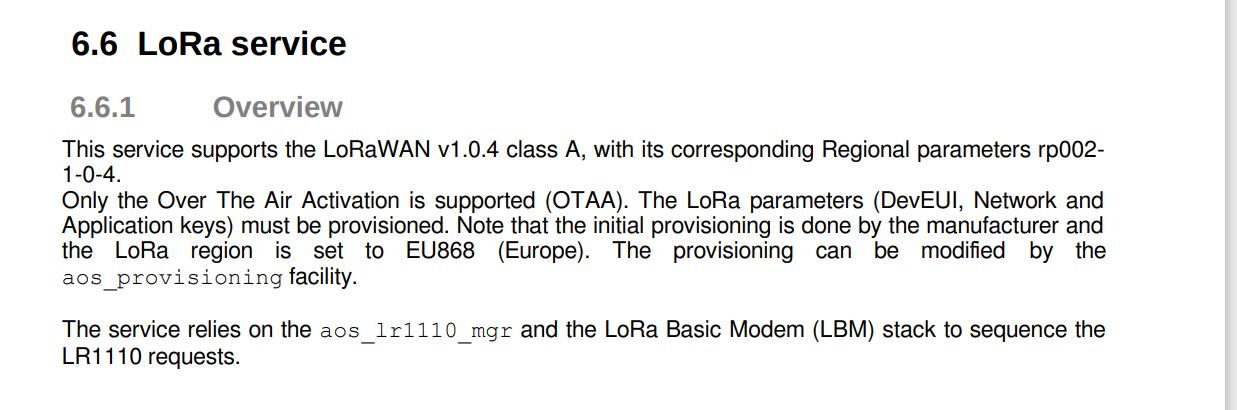

In the user guide they have mentioned this:
“The LoRa parameters (DevEUI, Network and
Application keys) must be provisioned. Note that the initial provisioning is done by the manufacturer and
the LoRa region is set to EU868 (Europe). The provisioning can be modified by the
aos_provisioning facility.”
But I am not exactly sure how to implement this.

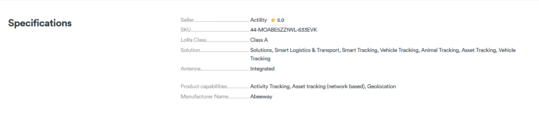

Without knowing the details of the device manufacturer & part number and making it easy on us volunteers to read the manual, a link, this may take some time! Sure, we can Google “1WL EVK” but is it what you have?
Murata Part Number: LBEU5ZZ1WL-633EVK

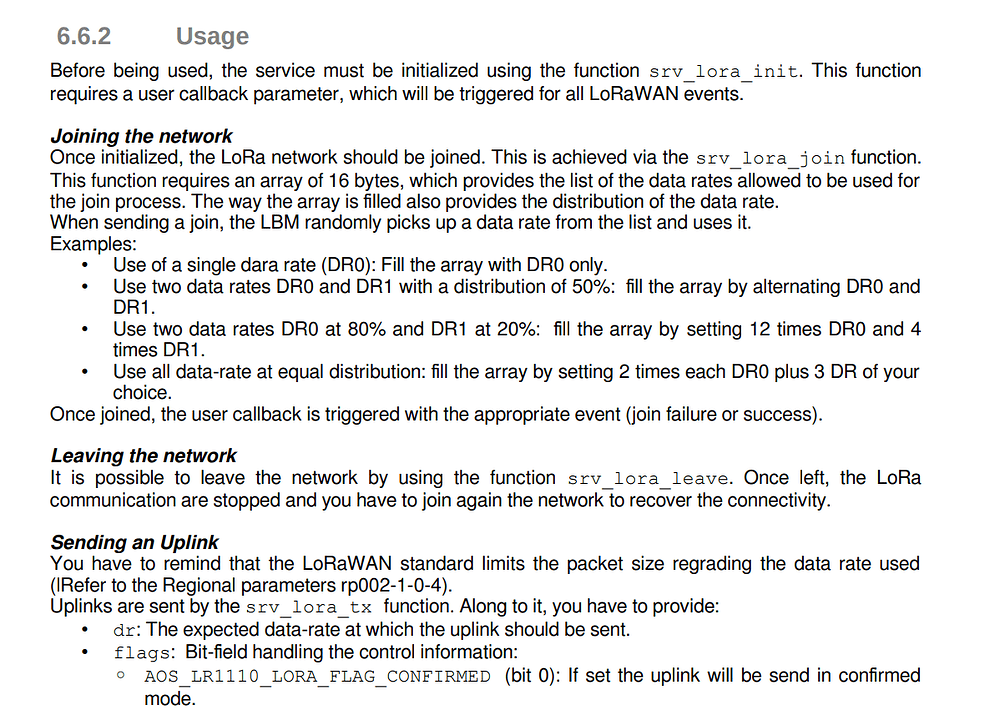

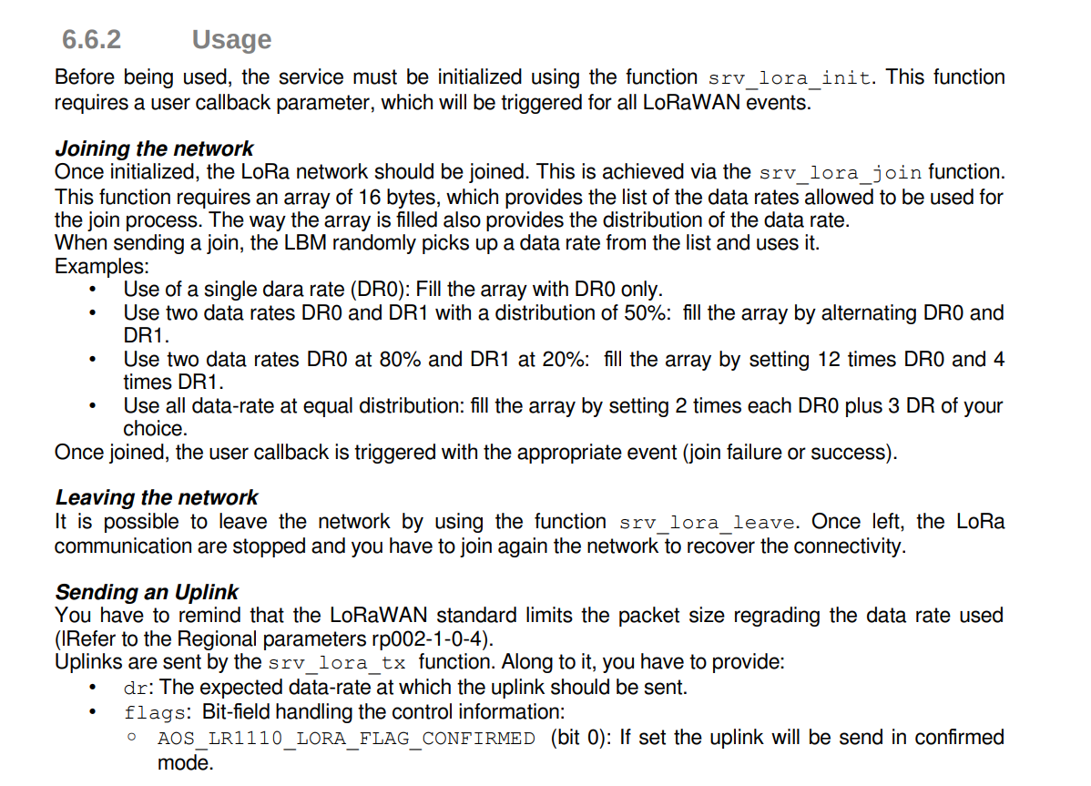

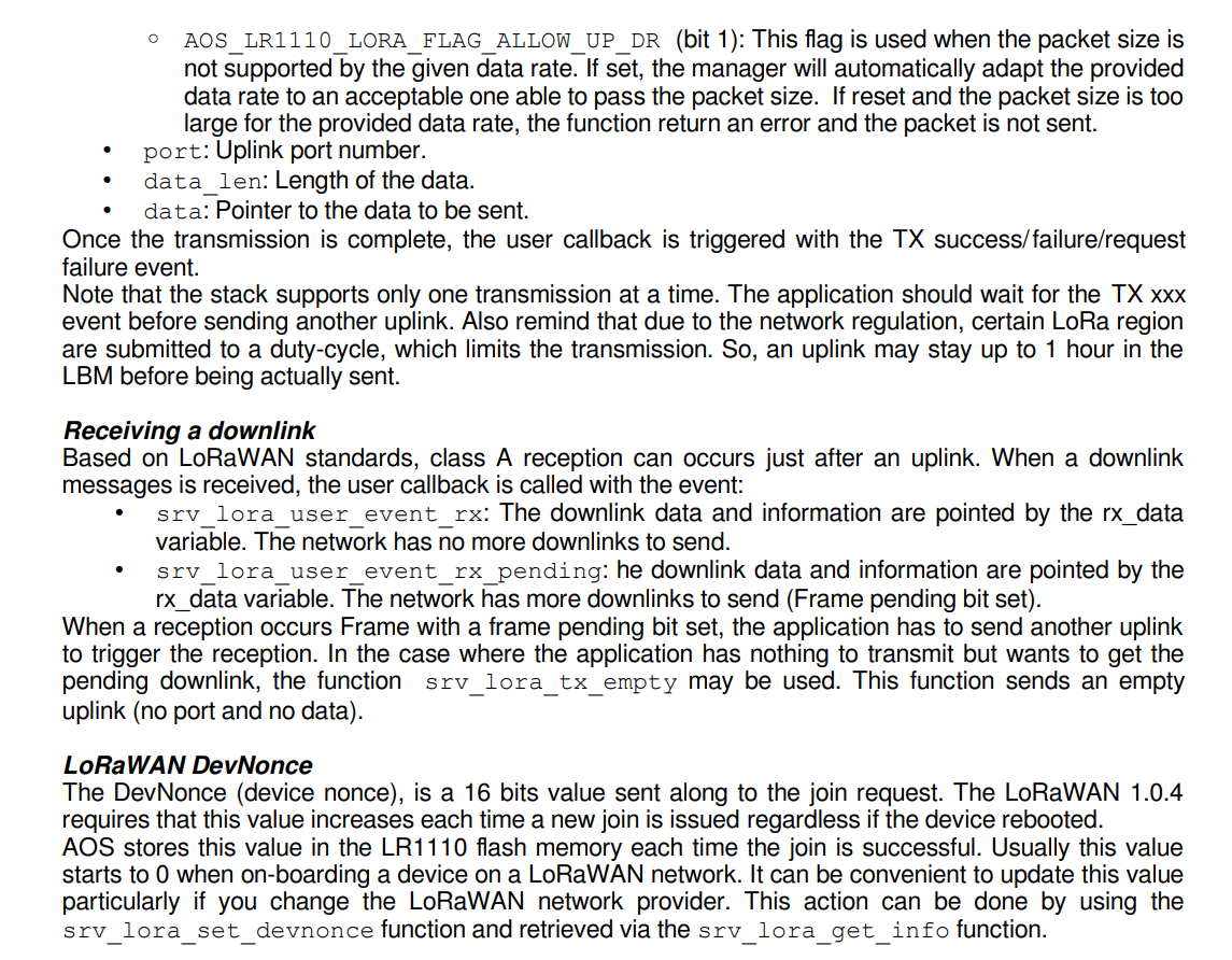

These are the snap shots of LR1110 service provided in the SDK user manual
Both of these imply that there is some sort of command line interface which isn’t really very obvious in the documentation you’ve linked to. Where did you get the details on the provis lora set appkey command?
