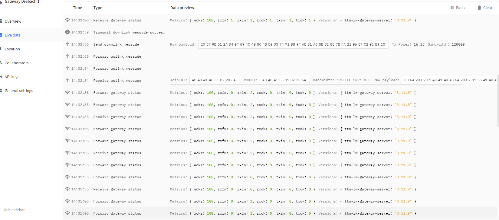

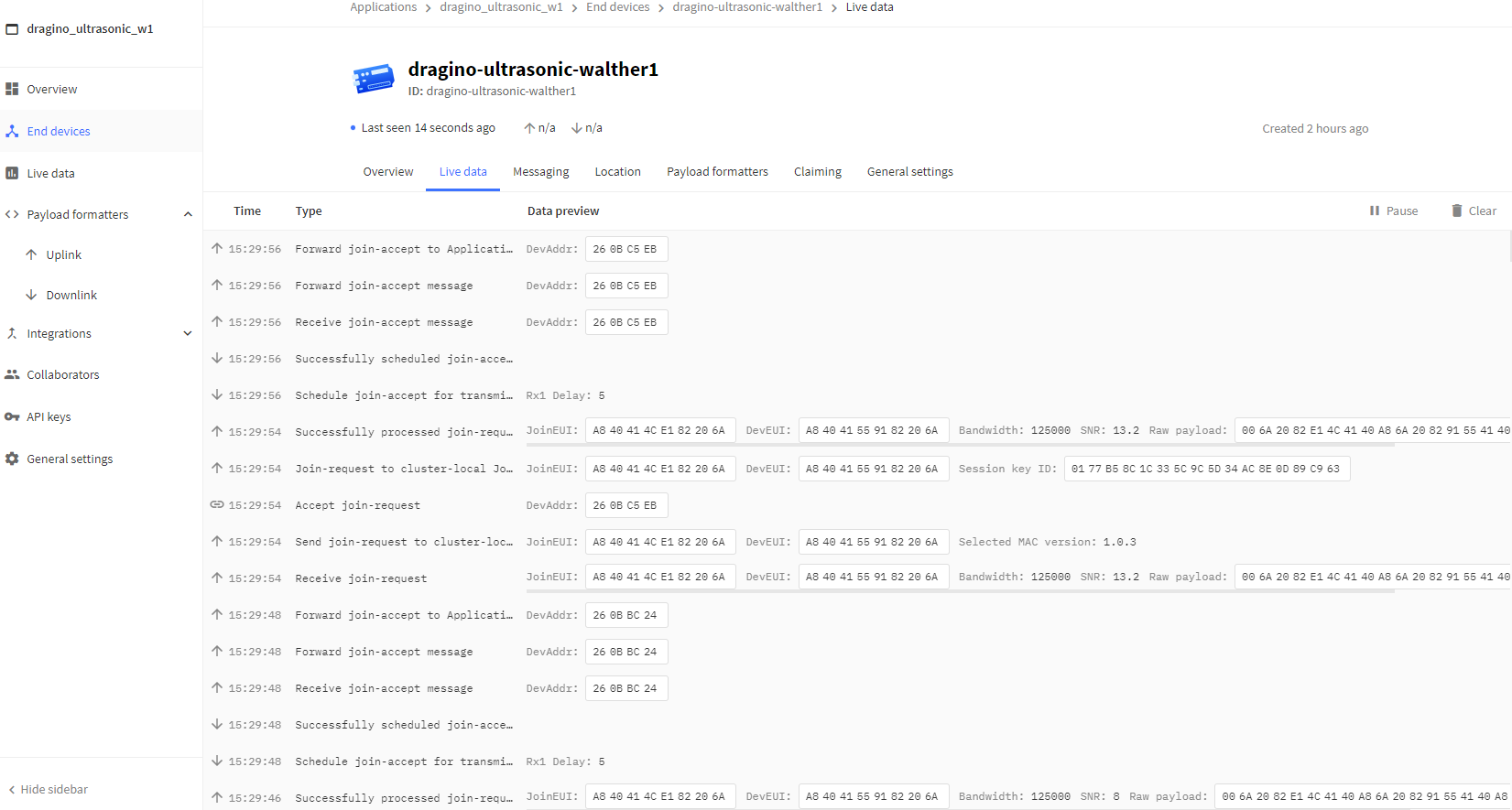

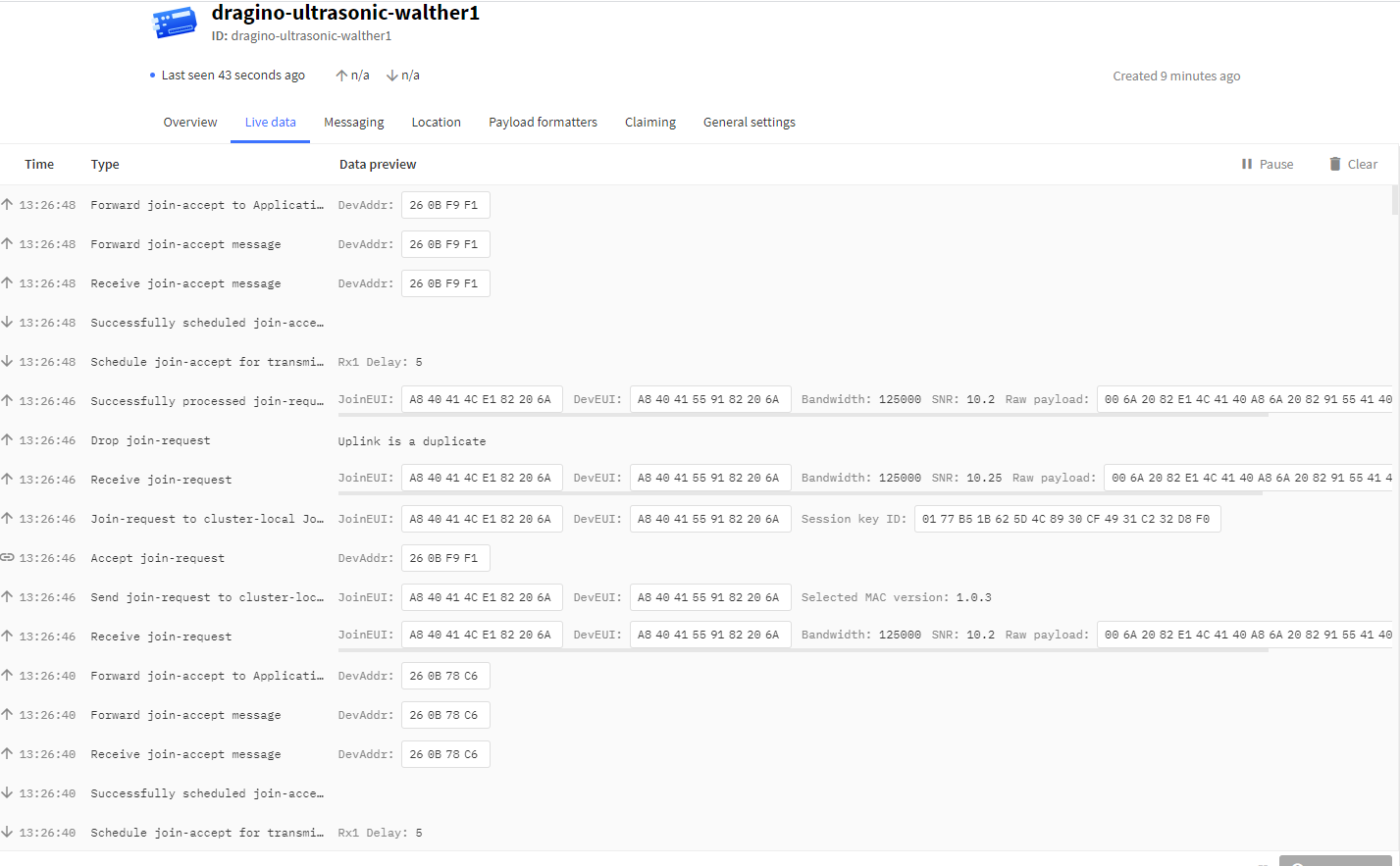

I have deleted and re-created a new device. Now the MIC mismatch is gone, but it endless loops the join process:
join

From gateway view it looks ok, but device is not working. downlink
Still endless join loop. Try go get in contact with dragino. join
