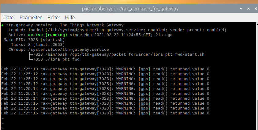

The service is running fine:
grafik

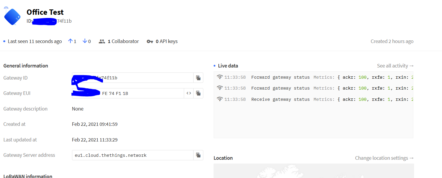

@descartes
Thanks, that did it…
grafik
I was a bit irritated by the documentation that suggests the EUI is kind of optional now ( Gateway EUI (if your gateway has an EUI).
Anyways, it’s working, feeling bad after bothering @bluejedi als :smiley: :
