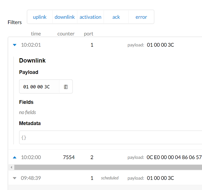

@topocare_scholz is the device sending data at all ? – so can you see uplink-messages in the ttn v2 console ? and if this is going well - can you see your downlink message in the console too ?
Yes, it is sending data just fine every 20 minutes.
Here is a screenshot of my console after scheduling the downlink for a 1 minute interval and the next uplink.
downlinkConsole
