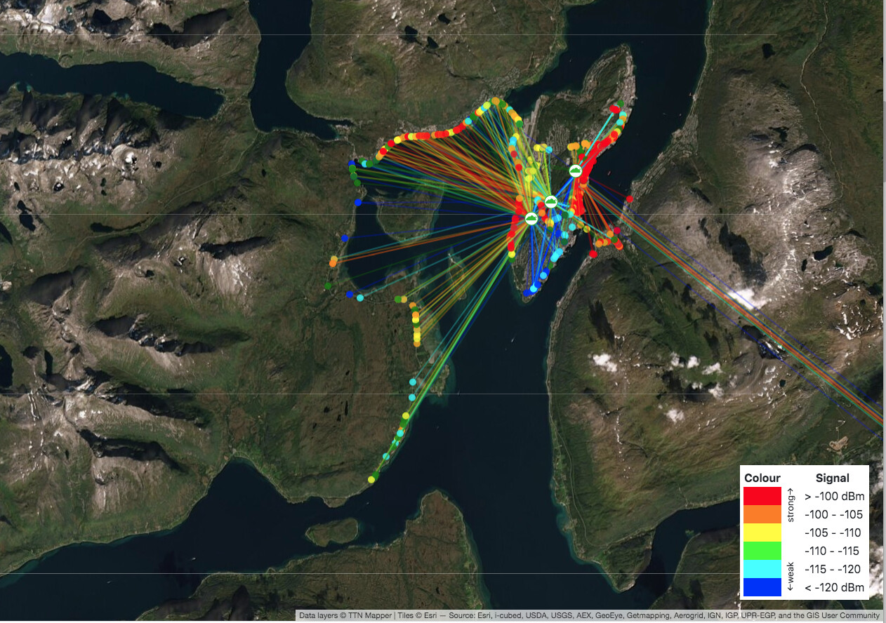

I have 3 of these( and a 4th soon to be mounted) in the arctic conditions in Northern Norway, and they have survived snowstorms, rain and wind(over 100km/h wind some times). I have mine mounted on tall(40+ meter high) buildings in strategic positions, but due to challenging geography, I haven’t had the change to really test their LOS range.
TTNMapper experiment-data: TTNMapper Test Experiment (there’s one third-party gateway which has the wrong coordinates)

Really good coverage, specially taking into account all the surrounding water masses (Knife-edge effect)
