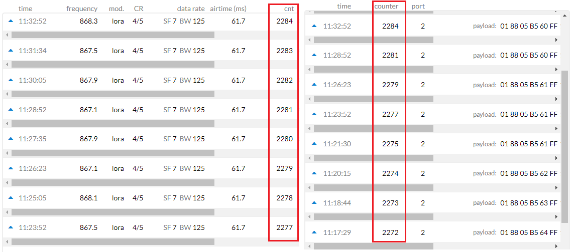

Hi all!
Since I started my application, I have had missing packets on the Application data interface, so I thought that the packets were really missed in the way node-gateway. The thing is that I noticed that in the gateway traffic interface, the message really reaches the Gateway. So, in summary, all packets are seen on the gateway traffic, but some of them doesn’t appear on the application data interface. What could be the reason? In the image below, you can see that packets 2278, 2280, 2282 and 2283 are not in the app data (right) but they appear on the gateway traffic (left).
Thanks!.

This seems to be a different case because the data is available in the database integration. So the back-end has received and processed the data, just not forwarded it to MQTT.
Precisely what we had: packets seen in the gateway traffic, but not in the device traffic.
