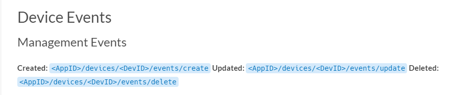

I’m trying to get notifications of when devices are created/updated/deleted in a TTN application so I can manage the provisioning of them in another system.
In the API documentation https://www.thethingsnetwork.org/docs/applications/mqtt/api.html there is some information about device events which look like what I want.
After some trial and error my dotNet client can connect and I can successfully subscribe to topics. I have tried the following topics (can’t find much documentation about topic formats) but when I create/delete/update EndDevices in a TTN application I have not got any notifications.

I have had a look at the V3 docs at
https://thethingsstack.io/integrations/mqtt/
There don’t appear to be any references to device management events unlike the V2 docs at
Where there is only the briefest mention of device management events
Are device management events supported in V3?

The scope of the v3 Application Data API that is available over MQTT is limited to the (LoRaWAN) Application Server. The documentation for it can be found on the page already referenced above: https://thethingsstack.io/integrations/mqtt/
At time of writing, you can only subscribe to the following topics (wildcards are supported):
  • v3/{application id}/devices/{device id}/join
  • v3/{application id}/devices/{device id}/up
  • v3/{application id}/devices/{device id}/down/queued
  • v3/{application id}/devices/{device id}/down/sent
  • v3/{application id}/devices/{device id}/down/ack
  • v3/{application id}/devices/{device id}/down/nack
  • v3/{application id}/devices/{device id}/down/failed
  • v3/{application id}/devices/{device id}/service/data
The v3 Events API that includes events from the entire stack (including device create/update/delete events) is currently available over gRPC and HTTP streams only, not over MQTT. The API reference for it can be found here: https://thethingsstack.io/reference/api/events/
