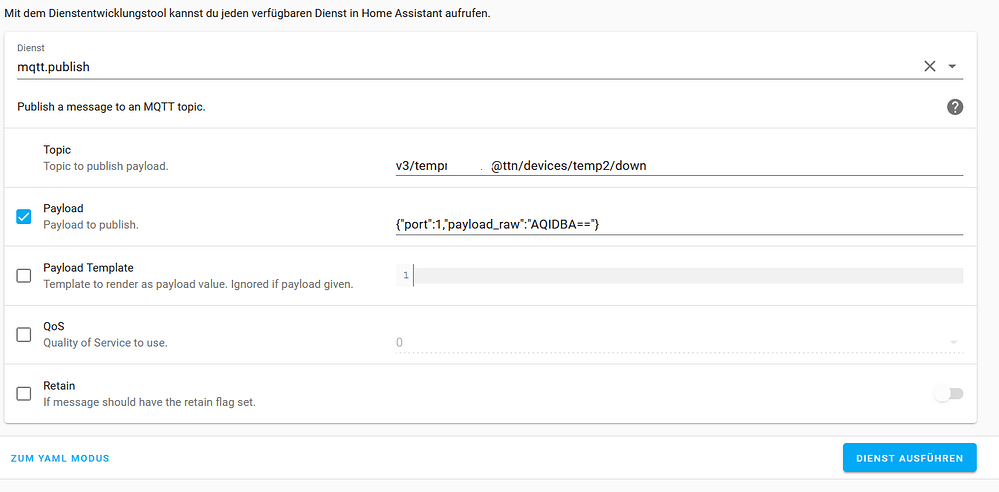

Now i want to schedule a Downlink Message over my Home Assistant Server.
In my local MQTT the message appears in my MQTT Explorer, but i dont think that it can pass the bridge to the TTN MQTT Server
I also tried the topic with /push after /down but nothing changed.
Would be nice if someone could tell me how to publish a Downlink message over a bridge.
Best Regards
The Payload was wrong. It works now.
{"downlinks": [{ "f_port": 2, "frm_payload": "AQACWA==", "priority": "NORMAL", "confirmed": true}]}

I followed your configurations and in my HA I ran MQTT Publish with my configurations but does not pass the bridge to MQTT TTN.What is your solution? Thanks in advance.
