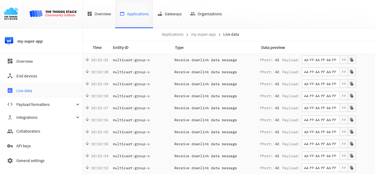

I have managed a successful Multicast session.
My team has worked on this feature and we’ve documented it. But not just that. We also worked on Clock Synchronization, Data Fragmentation and FUOTA.
