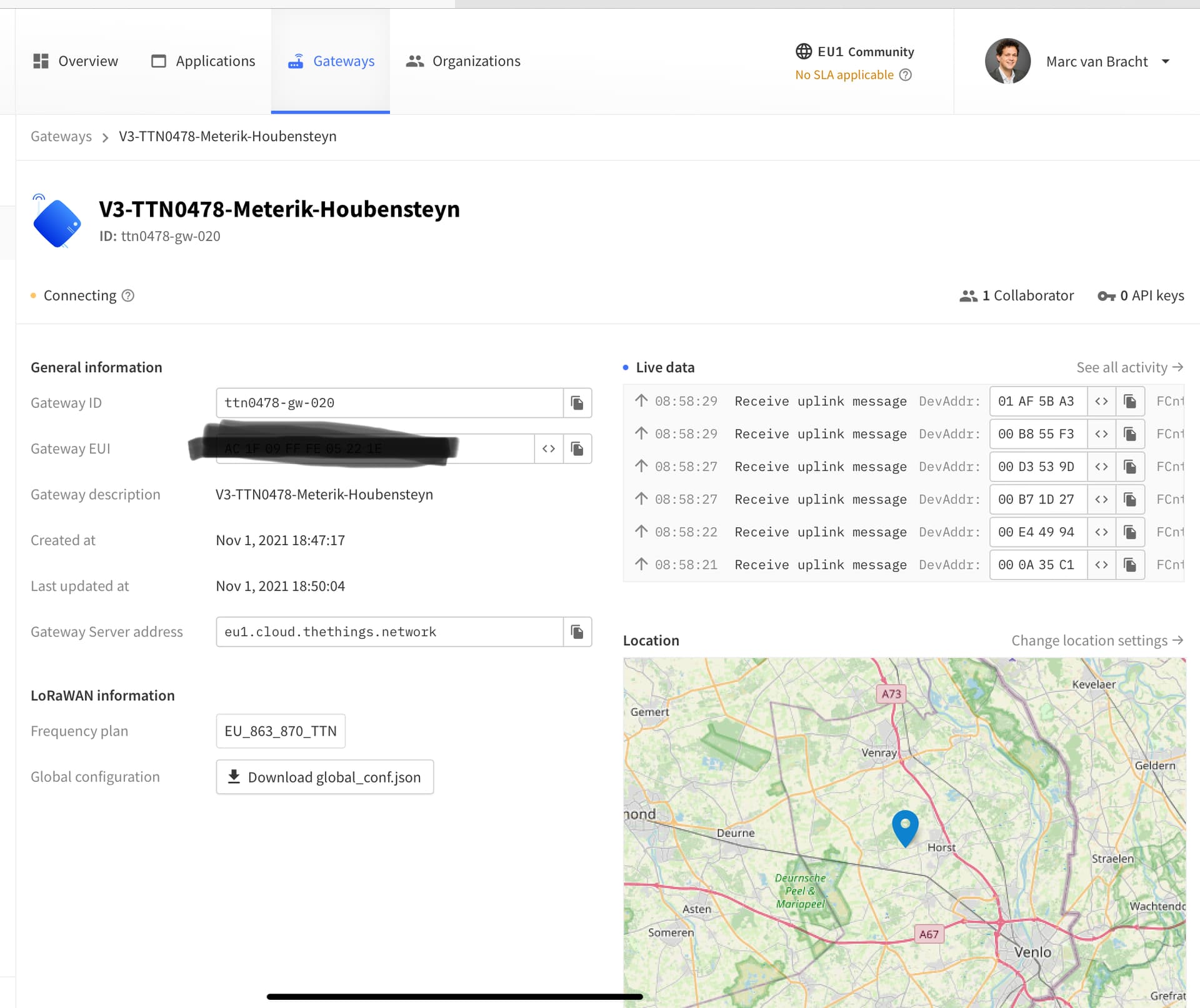

Did you check the TTN gateway console if there is any data coming in? And if the gateway is correctly added in TTN?
See my 7268 gateway in the screenshot. There must be live data coming in
If the gateway is not connect (status BLUE) in TTN, you first have to solve that problem over there
Marc
If not, I cloud help remotely to add it into TTN (i have 21 RAK gateways ;-))
Marc

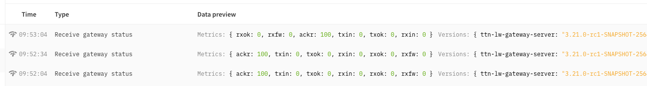

Yes, i have blue status in TTN and I receive Live-Data
grafik
But I guess, like you see in the screenshot, it is allways the same content. I exept, that if the gateway would receive data from a device (like a temperature sensor), there must be another payload and content. - Is the right?
Thanks for your help - and best regards - Daniel
Yes, but it really is as simple as getting an known good device - like a Dragino door sensor which is about €25 and setting it up.
Because if there are no devices in range of your gateway, you will not get any traffic.

as @descartes already answered you have no devices that is sending data via your gateway and therefore you see only the metrics of the gateway itself.
