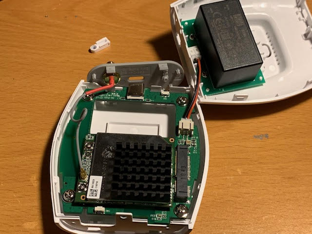

However, RSTn line is datasheet spec’d to be 1k pulled-on, ā€œā€¦ In all cases, a 1 k pull-up on the RSTb pin is recommendedā€¦ā€, so some 3mA @ 3V3 supply.
Otherwise, there’s a chance the onboard PS can be loaded to some max. 100mA because of the RSTn sinking behaviour. See Table 3.10. Absolute Maximum Ratings on page 15 of the datasheet.
So, either remove the pulldown and add 1 to 10k pull-up; or simply add a pull up of some 1k as R86, so that you form a divider with the R88-10k one.

That is a very good point, thanks for checking it out… from the datasheet it looks like the module drives the pin at power on reset and power failures. I just swapped my short for a 1k pull-up and it works allright. It also looks like the signal is routed somewhere else on the board (there’s a via going to an inner layer)… wondering if it could be enabled from the main MCU via a firmware update… that would be even better!

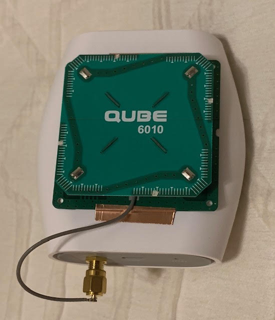

I think I voided the warranty on my gateway. But it seems to have a little more range.

the same antenne as used by Lacuna-space a ā€œSquare Quadrifilar Spiralā€ antenne
http://www.phychips.com/product-antenna/
