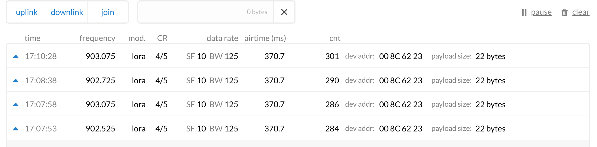

They are now at weird frequencies and they are actually outside of subband and don’t follow the appropriate 200 hz step interval ie, 902.725, 902.325, 903.075.
I’m sending every 5 seconds btw
It’s actually always seemed to have used weird frequencies when I unplugged all of my other gateways and used it solely. When I have it running along side my other gateways it doesn’t see any packets.

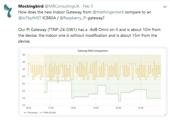

Nice GW, where can I buy one ? And is it more reliable than the TTN KS GW ?

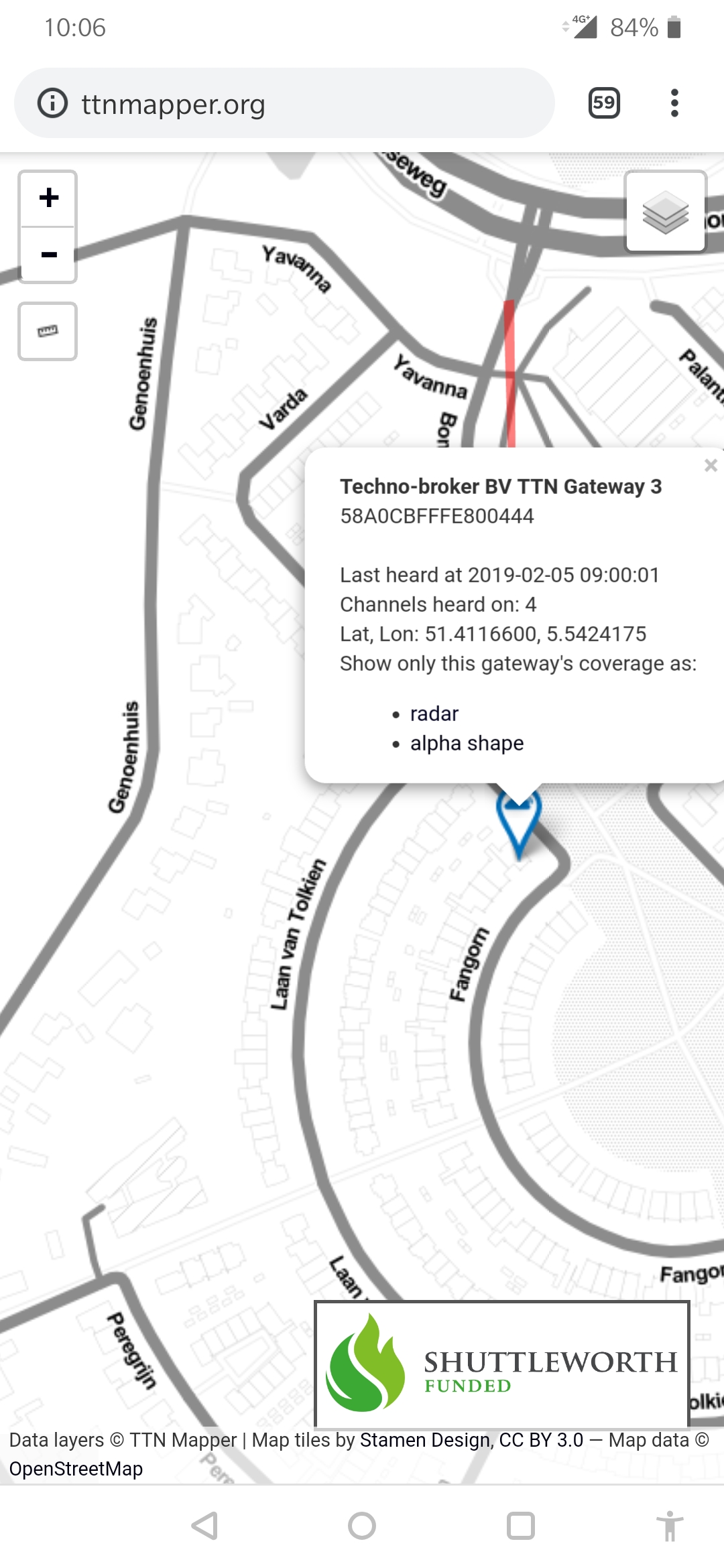

The conference indoor gateway was easily installed here (due to all usefull remarks in this thread!
). Strangely enough, ttnmapper reports that my gateway was only seen on 4 channels…and this is confirmed by my experience that a number of packets is dropped. Anyone similar experiences?
That’s weird. We fixed the channel config mismatch for the US version also. We had some unrelated issues on the US bridge where users are reporting their gateways are not visible.
That is now resolved. Can you check if your gateway is still doing this?
