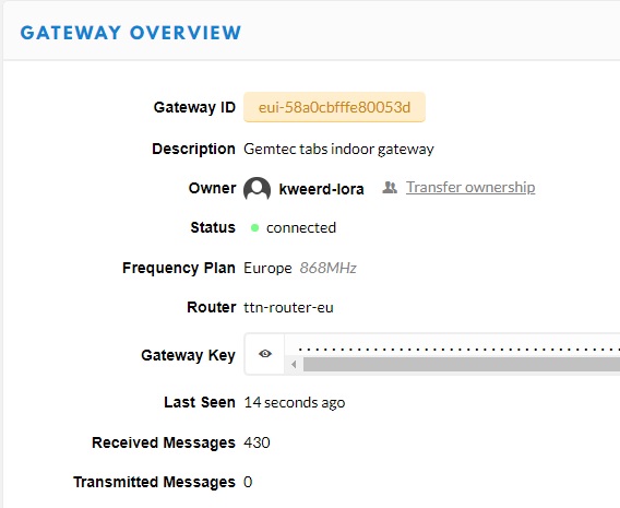

I had the same problem: Gateway did not appear as connected with fffe’d EUI in the console.
I have sent some test packets and suddenly saw that they were received by my IMST gateway (as expected) and another gateway, which must be really nearby (from RSSI) but has a completely different EUI. I then tried to register this EUI and it was immediately connected. I have now confirmed that this really is my TTN Indoor Gateway (by moving around and sending more test packets).
But the EUI is not related to the Wifi MAC at all:
  • my Wifi MAC starts with 68:c6:3a:…
  • my EUI that appears on Console and now works starts with 58:a0:cb:…
This tells me for my situation: EUI is not derived from the Wifi MAC. The Wifi MAC printed on the device is the same as show on my Unifi Access Points, so that’s consistent.
My suggestion: look at the packets you send and find out if another Gateway receives them nearby. This could be the EUI of your TTN indoor GW.

take the Gateway EUI, but small letters without ‘-’. that should work. if not take with leading ‘eui-’.
after connecting to TTN your complete GW-EUI should look like:
eui-58a0aaffeaaaa00

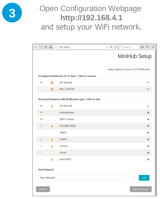

Step 3
Huh!?

I just repeated setup to look. press the setup button not the reset button. connect to the new AP ‘MiniHub…’. on the bottom of the page 192.168.4.1 you will find the datas of your GW. scroll down the page.
after that you need to connect to your own network by clicking your wifi on the list. put in the credentials and save. after a reboot and some time the gw will be connected to your own router. then you can start in the TTN console as described in recent mails before.
I hope, you can figure all out.
