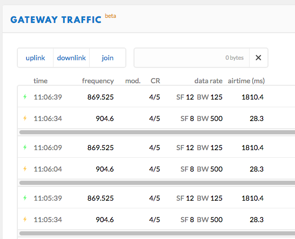

Maybe those are only EU868? I also see 178 EUIs starting with eui-00001c497b

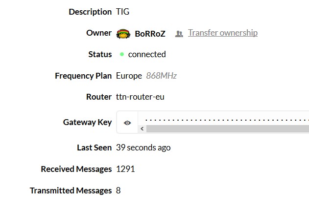

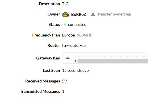

Many of those are registered for EU868 as well, but maybe theyâre really US915 devices configured for EU868 in TTN Console. (I donât know how many people got the US915 device when the EU868 was no longer available at the conference.) The EUI surely determines the frequency plan/configuration, so multiple ranges might be expected:
âŚthough it seems the above might only apply to receiving uplinks, as settings in TTN Console affect the frequency for Join Accept downlinks. At least those that are displayed in TTN Console, for a US915 device configured for EU868:

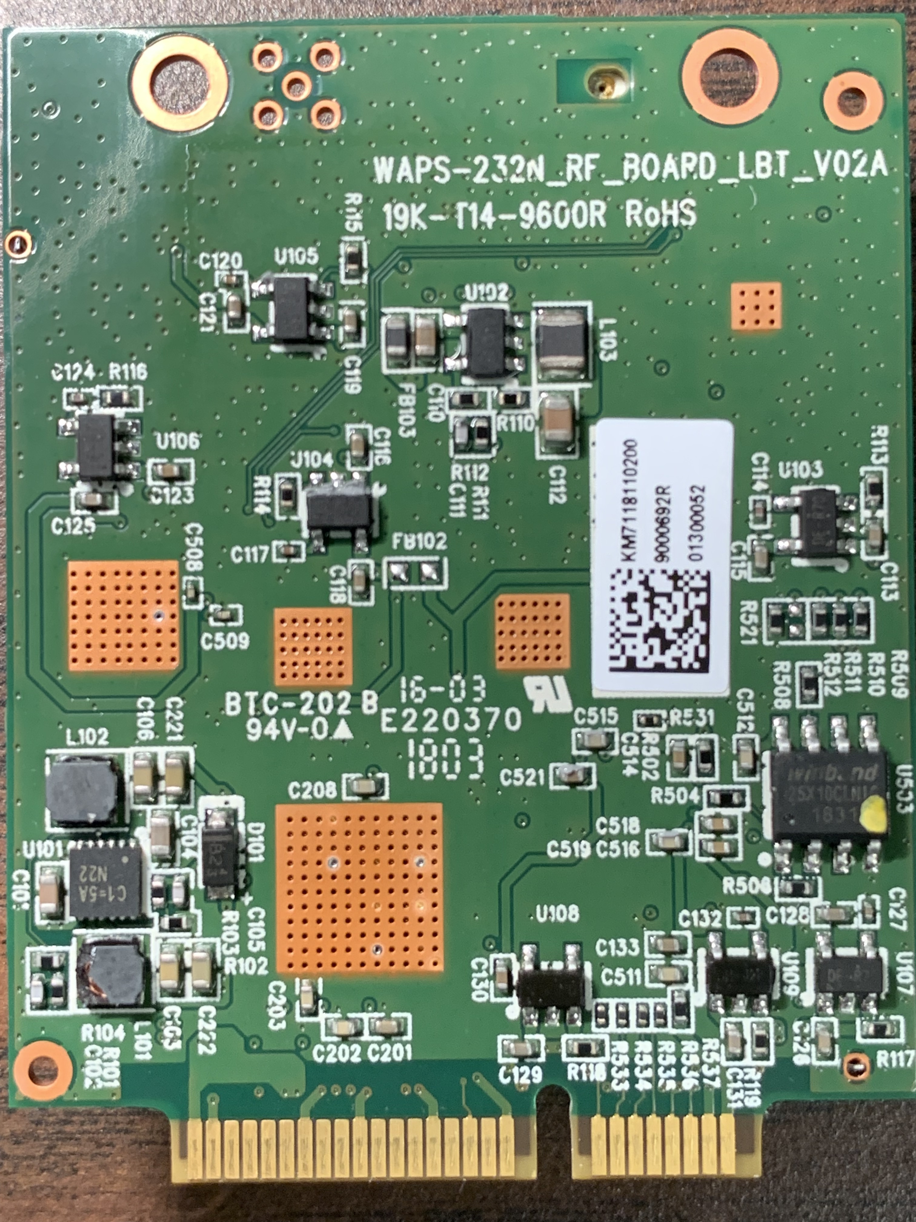

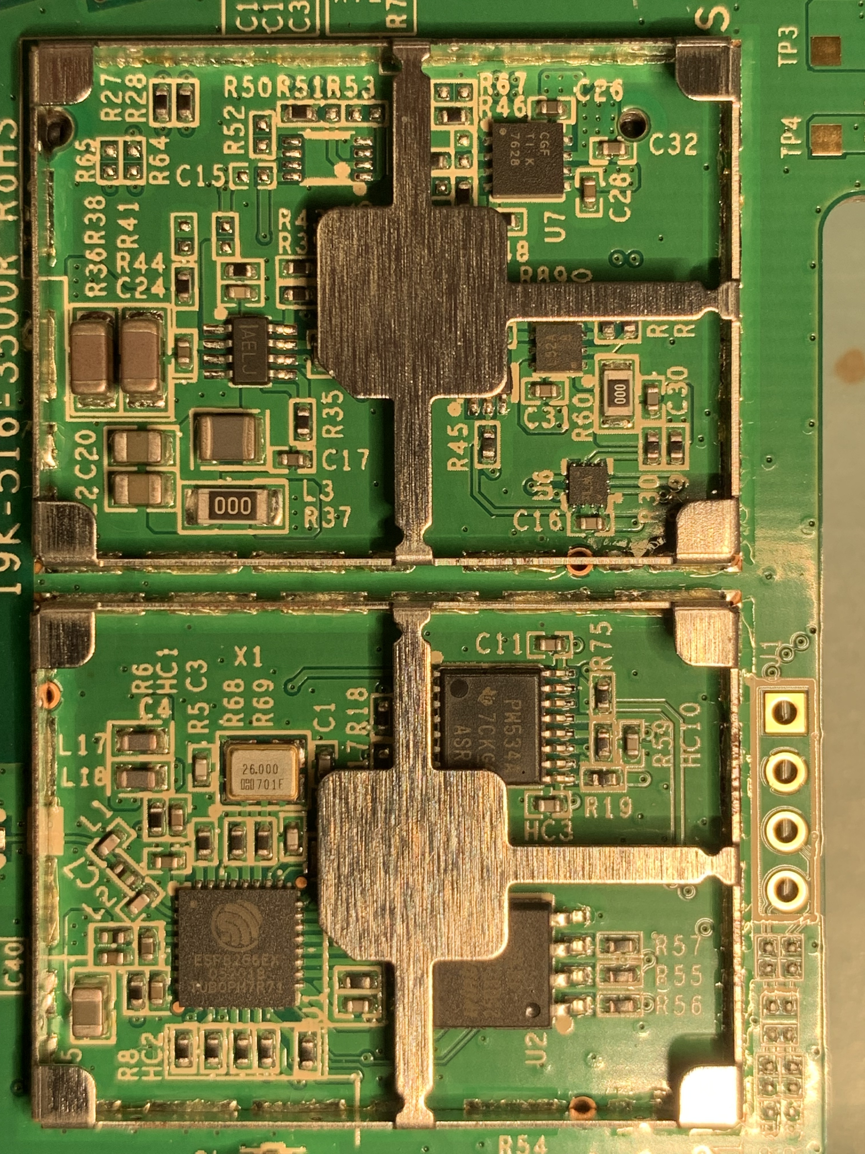

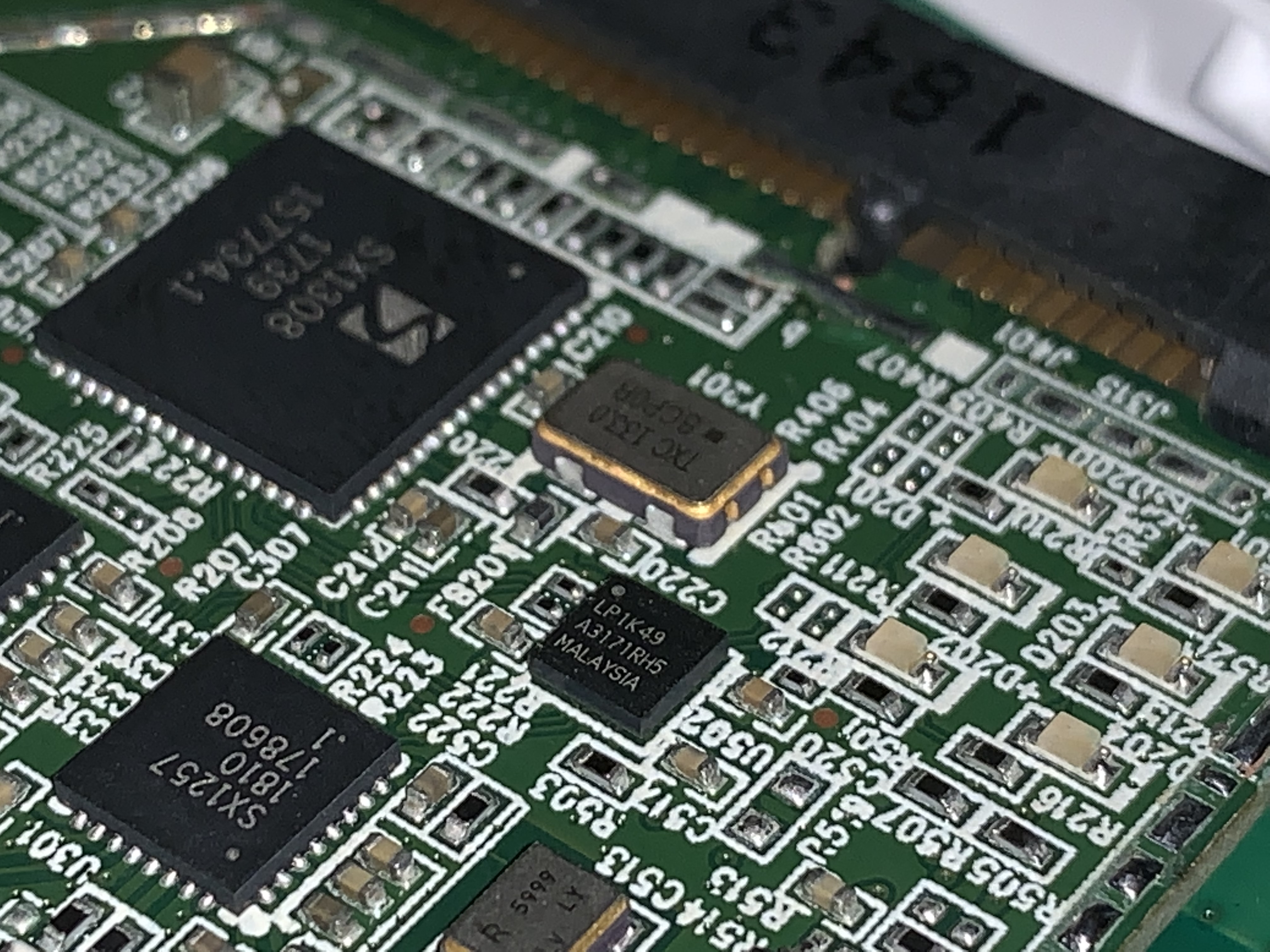

A few more pics.

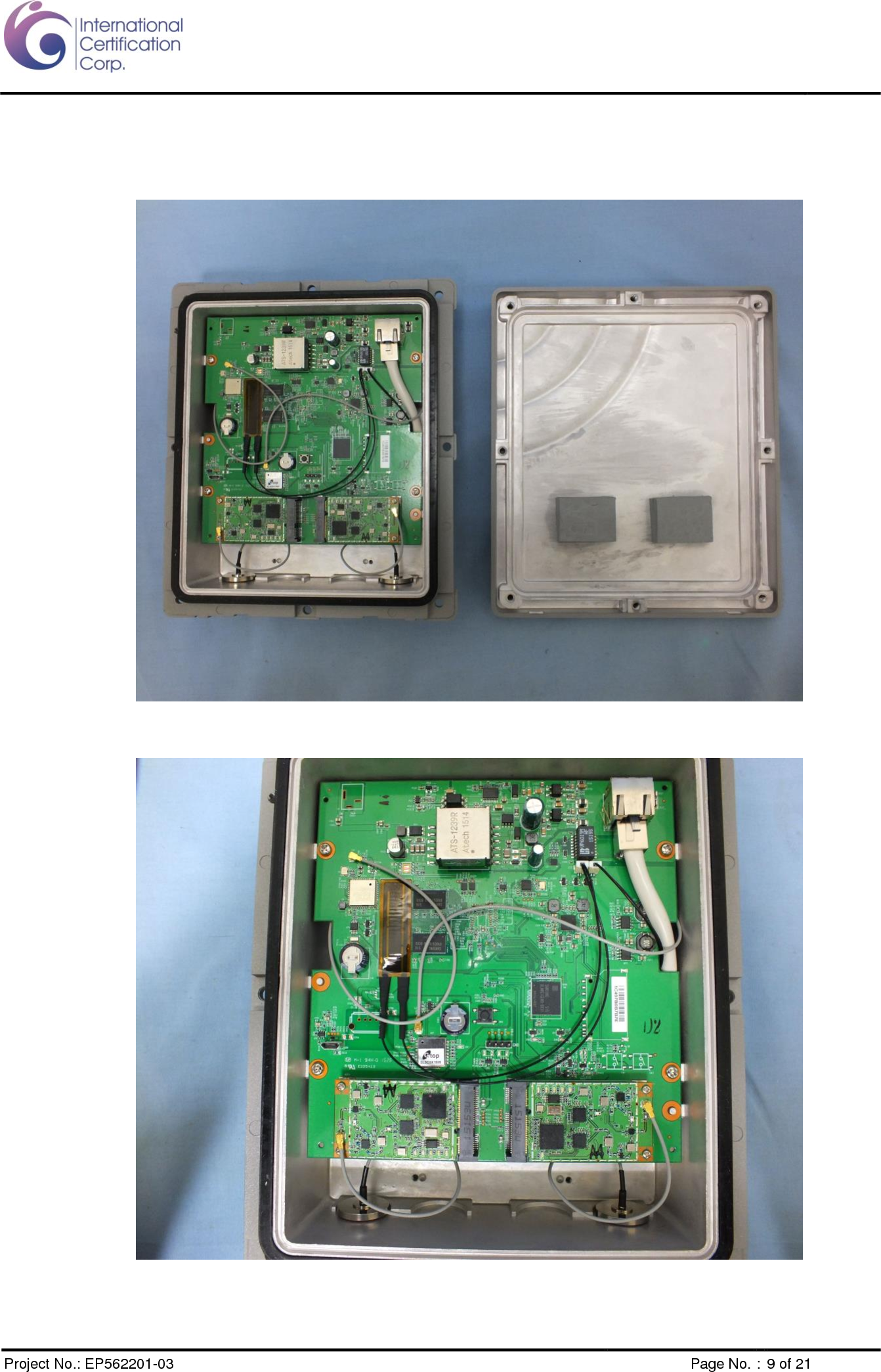

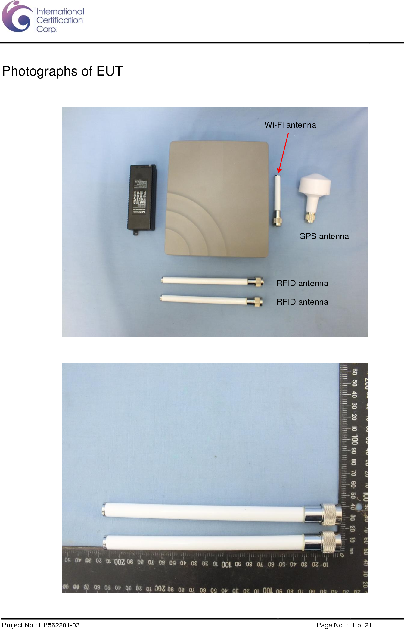

Looks like this is a part of this one:
âLBTâ = Listen-before-talk?

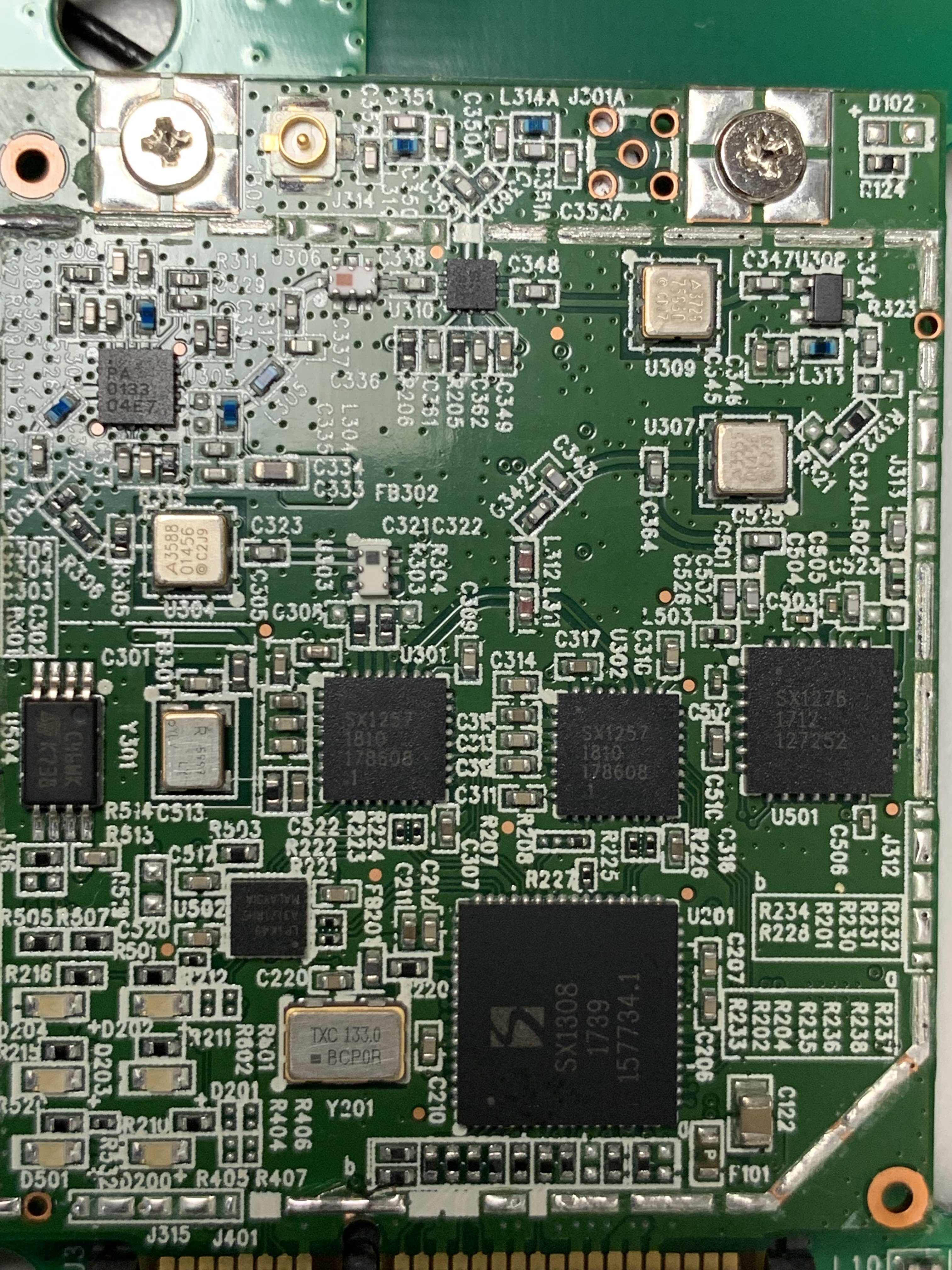

The module in the FCC documents looks different. Here is the actual concentrator âunder the hoodâ . There is an ICE40 FPGA in the TX path of radio A.
Probably yesâŚnote the additional SX1276 - probably used for the âListenâ
