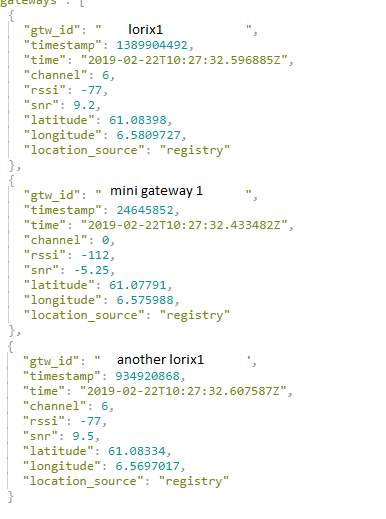

I have multiple gateways picking up my messages, however when I look at the metadata and see the different gateways recieveing my message I see the following:
On my mini gateway (handed out at the conference) the channel always display 0, while the other gateways that picked up the message shows the “correct” channel, see attached image.
Also, I’ve seen the minigateway show SNR of +15, while the lorix1 showed -12 (highly unlikely).
the “another lorix1” is approximately at the same distance as my minigateway to this perticular node shown in image below, both of the lorix gateways are mounted outdoors ~5-10m above ground.

I’d say that if all gateways use the same frequency plan, then the metadata should show the same channel.
maybe they are numbered in a different way in each concentrator :drooling_face:
Ah, I assumed that TTN determined the channel number given a frequency, SF and bandwidth. But maybe you’re right that the gateway determines and passes the number, and TTN simply shows the number it has been given.
TTN stack V2 does not implement the new Basic Station protocol. Somewhere in between your gateway and the TTN stack there is a process running to translate the new protocol back to the ‘old’ Semtech UDP protocol. The sources of the Basic Station packet forwarder include python code for this purpose and a quick glance does not reveal any code handling the channel.
The channel number is based on the configuration. The frequencies defined in the configuration block is matched. So any gateway using a configuration with frequencies defined in a different order will report a different channel.

Okay, so it does not match the channel number from the LoRaWAN Regional Parameters document. (And if it should, then TTN would not have added the value to each gateway, as then it should be the same for all.) Does anyone know what’s the use of the channel number in the metadata then?

Looking at the Basic Station software it seems no longer to be present in the uplink data. So it probably wasn’t/isn’t useful.

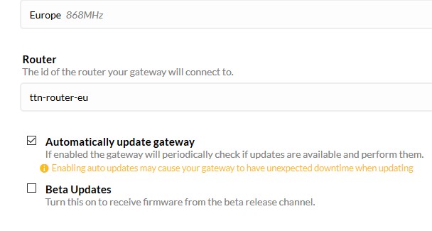

betaupd
do you have to check 'Beta Updates ’ on TTIG ?
