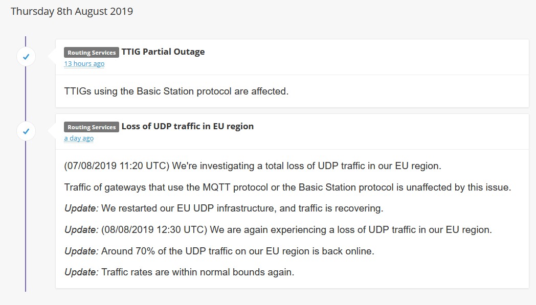

TTI is working hard to solve this… watch your GW’s / status page :sunglasses:

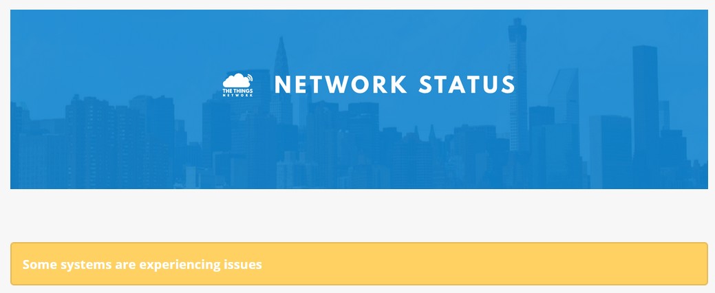

Anyone got their gateway back online? Mine seems to stay down even if the status pages says ā€œAll systems are operationalā€?
Funny thing it states that it was online two hours ago :frowning:
TTIG in Berlin is online again. And a lot of new TTIGs also… as an effect of debugging i suppose

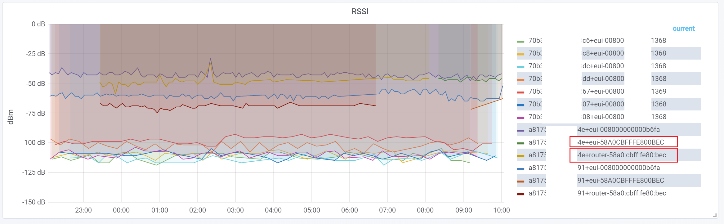

Noticed this yesterday. Today I looked at the RSSI history for my nodes and I see there’s strange behaviour in the metadata (gateway field) seems to be altered a couple of times. Normally I see the DevEUI address as below (Note the time seems to be broken despite device being ā€œupā€):
  "gtw_id": "eui-58A0CBFFFEXXXXXX",
  "timestamp": 15006171,
  "time": "1970-01-01T00:00:01.565341333Z",
  "channel": 0,
  "rssi": -63,
  "snr": 9.25
But look back here earlier today: colons, router names, all caps for a while… but only for devices via the TTIG device. All very strange:
Capture
04%20PM
everything seems back to normal now … thanks team !
Would be good to know why/root cause and what was done to fix/prevent future issues (other than turn it off, turn it on again! :smile: ) - to build confidence… :thinking:
Understand Basic Station -> V2 bridging a bit flakey but basic UDP traffic handling?..
