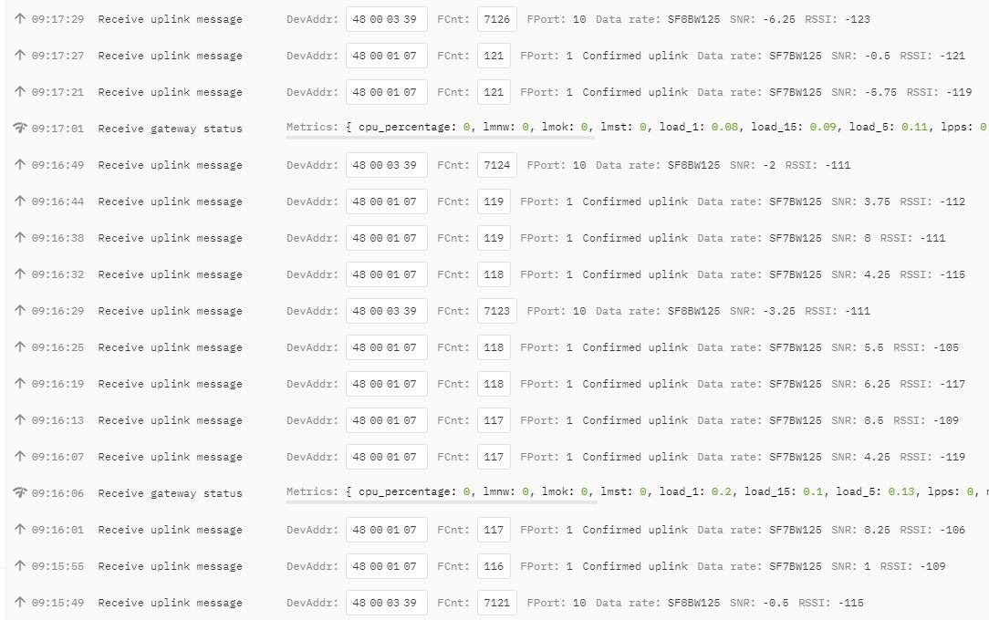

Today I am getting frequent “Confirmed uplink” messages with good SNR, but sadly only a few seconds apart. Device Address suggests this is not aimed at TTN, but it is still having an impact :frowning:
ConfirmedUplinks
This is probably one of the rare cases where a yagi could be justified (hooked up to my movable gateway) :wink:
I don’t understand - under what conditions does a new bit of kit need justifying?
I’m not saying I would have to use a yagi(!), but to help get a bearing on a rogue signal, it would be invaluable. Otherwise, I left with just sampling RSSI/SNR in different locations while the rogue broadcaster is active.
Who knows, it may be just an experimenter in my own street, or a user with excessive power further afield. If I can just peak up the reception signal strength I’ll have more chance finding the source.
And in the end it may turn out to be perfectly legitimate use of the band and not a rogue experimenter!

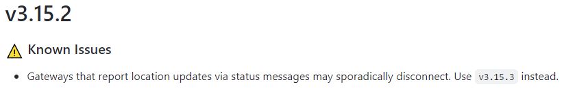

This seemed the right thread to include this known issue, just FYI:KnownIssue
