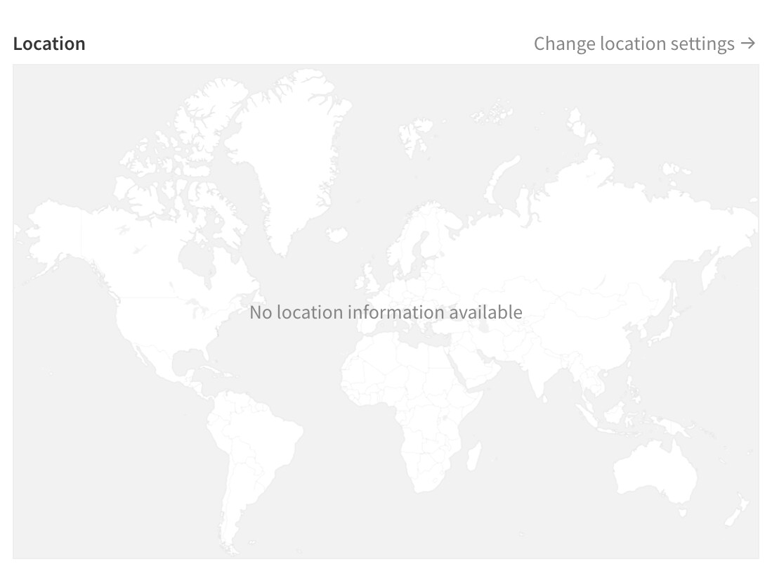

V3 Gateway Console not GW-GPS-Information are shown in the Console
Hallo,
there is the option to take the GPS-infos from the GW to fill in the GPS-Position in V3-GW-Console:
Location → Update from status messages
In the status package there are the information, but not shown in the console!

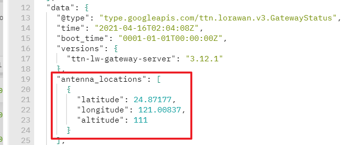

  "name": "gs.status.receive",
  "time": "2021-03-11T13:45:47.295329707Z",
  "identifiers": [
      "gateway_ids": {
        "gateway_id": "xxxxxxxxxxxx",
        "eui": "xxxxxxxxxxxxxx"
  "data": {
    "@type": "type.googleapis.com/ttn.lorawan.v3.GatewayStatus",
    "time": "2021-03-11T13:45:47Z",
    "boot_time": "0001-01-01T00:00:00Z",
    "versions": {
      "ttn-lw-gateway-server": "3.11.2"
    "antenna_locations": [
        "latitude": xx.606757,
        "longitude": x.321227,
        "altitude": 100
What must i do that the GPS-Position from the GW are shown in the location-window for the GW?

I have the same question too.
I’m using the Semtech Packet Forwarder to connect to TTN Stack v3.
And I’ve setup the “Location source” with the “Update from status messages” option.
But the location of the gateway can be updated automatically even the “gateway status” was forwarded to TTN.
Does someone has the solution?
Thanks!!

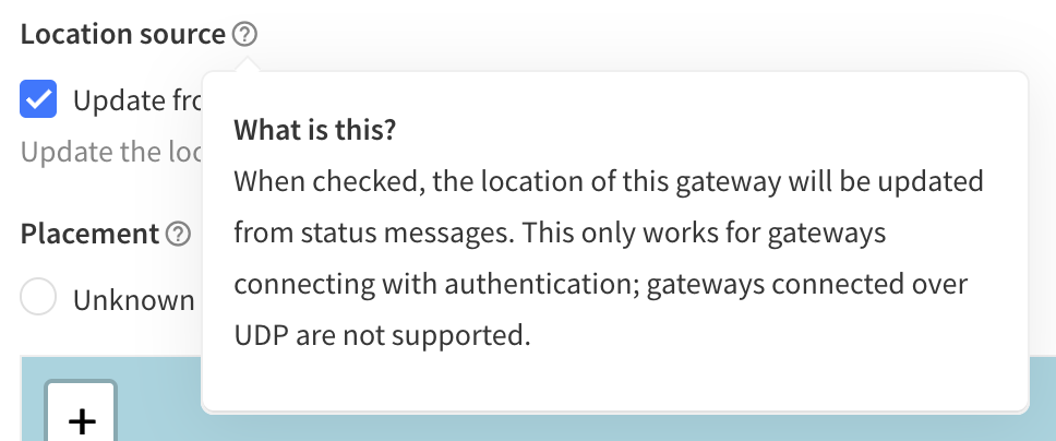

Like the posts above, it has “Update from status messages” enabled. But note the help text:
GPS location not for UDP
When checked, the location of this gateway will be updated from status messages. This only works for gateways connecting with authentication; gateways connected over UDP are not supported.

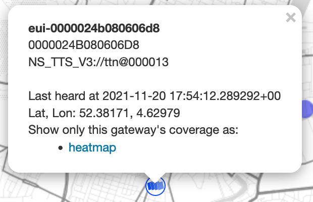

TTN Mapper is showing it nicely though:
TTN Mapper
Regardless, I now just disabled that checkbox and copied the coordinates and altitude from the message into Console, as it is in a fixed location anyhow.

Not allowing unauthenticated UDP packets to update the gateway location might be considered a security feature as there is no way to validate the information is provided by a gateway itself and not by an imposter. (Which happend a few years back)
