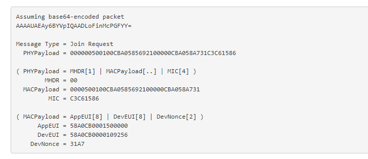

wow, i finally found the solution…
i checked the MIC with the online decoder you mentioned - and it was invalid
i copied app eui and dev eui from the join message, so only the app key could have been wrong
(but it definitely was the pre-defined value given to me by the distributor of the tabs sensor device!)
i went with my gut feeling and just tried using the given nwkskey in place of the app key - and bingo! i got a valid MIC
the distributor just mixed up the values…
now the join request got accepted by ttn and i’m seeing the first regular sensor messages
thanks a lot for you help and pointing me into the right direction to validate the MIC!

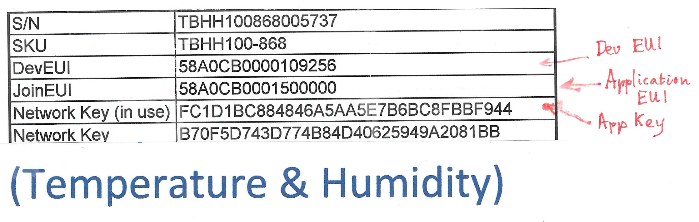

The tabs node T-RH did give me the same problem with the Join action. AppEUI and DevEUI are correct reported in the console gateway traffic. But Join did not work.
Here under the information i got from the producer of the node:
Tabs T-RH node b
The “data”, “payload” received in the console givesTasbs decode
At this moment i dont now the next step, please can you give me a hint.
Where can i find the nwkskey to replace the app key.
So, did you enter all 3 values (DevEUI, JoinEUI as AppEUI, and Network Key as AppKey) into TTN Console? See Registration of node with pre-configured LoRaWAN keys.
For the Join Request you could also validate the MIC by copying the Network Key into the field AppSKey of that online decoder (and just enter ‘00’ for the NwkSKey), to ensure that’s indeed the value that the device uses as the AppKey.
(Please don’t past images for what is text; like the output of that decoder.)
Thanks verry much. The online decoder gave me the information that both Network Keys were not correct, INVALID MIC.
Looking around at Antratek found that the prescription was not correct and that you should ask for a valid AppKey for your sensor. Antratek responded verry fast with a valid AppKey. That dit the trick.
