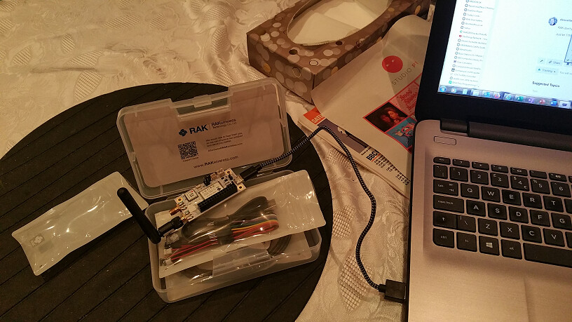

So pulled a new RAK5205 from stock, never been used before so as received from RAK, with stock firmware, (used as base for the 7204 I believe (minus GPS!)
And fired it up, using USB power from laptop:

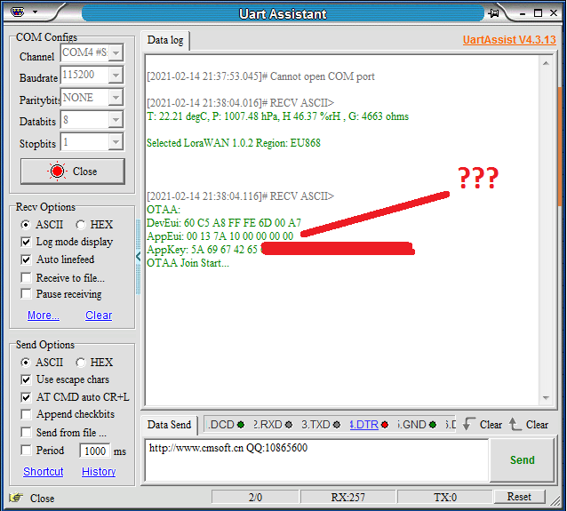

Sure enough when I look at the device settings what do I see but
BTW for this device they dont put anything on the packaging (or didnt at the time) and as you say I also see the Dev EUI on the sticker on the board - matching the screen shot.
Hence my quick suggestion, it may be what you say is true for other products.
Personally I find changing info in Console easier (using Manuf Id’s) & lower risk than me potentially bricking a device when reprogramming with TTN generated, unless I have to (you know how clumsy I can be )
I don’t get it… the device has an AppEui, a DevEui, and an AppKey, so what’s the problem?
I’d only expect the latter two to be unique per example. Did they forget to print the common AppEui on the sticker?
What am I missing?
There isnt one in the context of the last couple of posts
However the OP was having a problem getting his RAK device set up correctly in system wrt registration & joining so wanted clarification as to how to use/handle APP EUI’s - so I guess the answer ‘what’ is possibly reading higher up the thread “Nothing to see here, move along now…”, says a man in official looking overalls…
