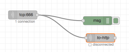

I haven’t build this yet, but I did a quick test with a local TCP input socket on port 666 (ah well) that feeds it into a TCP output.
[arjan@MacVoice ~]$telnet localhost 666
Trying ::1...
Won't send login name and/or authentication information.
Connected to localhost.
Escape character is '^]'.
temp.php?val=HOT
This gives me in the apache logs of the web server:
1.2.3.4 - - [09/May/2016:16:56:55 +0200] "temp.php?val=HOT" 501 214

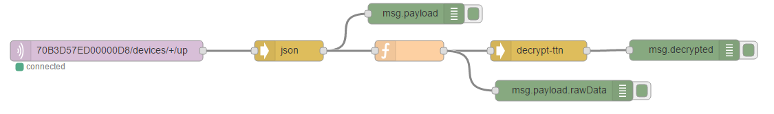

Do you also use node-red to decrypt the data? I’m trying Node-red at the moment (indeed really cool tool) with the decrypt-ttn module from willem4ever at Github.com (link to github) but getting the following error at the output:
RangeError: Invalid typed array length
I’ve created the following scheme:
Functionblock contains:
var newMsg = { payload: { rawData:msg.payload.payload } }; return newMsg;
Using this functionblock because decrypt-ttn expects a payload.rawData var which seems to be the payload.payload var in my MQTT response, is this correct?
My MQTT Response:
{ "payload": "qrvM", "port": 1, "counter": 5, "dev_eui": "0004A30B001B5FD7", "metadata": [ { "frequency": 867.5, "datarate": "SF12BW125", "codingrate": "4/5", "gateway_timestamp": 1833891972, "gateway_time": "2016-05-10T12:49:59.351748Z", "channel": 5, "server_time": "2016-05-10T12:49:59.36473891Z", "rssi": -75, "lsnr": 5.5, "rfchain": 0, "crc": 1, "modulation": "LORA", "gateway_eui": "B827EBFFFECF29A7", "altitude": 0, "longitude": 6.48105, "latitude": 51.94165 } ] }

I’ve seen the same issue. It looks like the decrypt-ttn node doesn’t work with the new (1.0) backend data structure - even if you feed it a msg.payload.rawData object.
@w4e, any plans to update it?

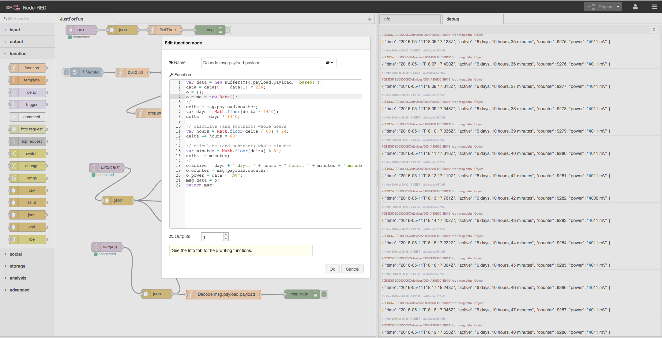

I don’t decrypt the data in Node-red. I decode it in the backend of my application (java).
The payload is already decrypted by TTN …
See below example for my Autonomo reporting each minute 2 bytes of data which is output voltage of the LiPo battery, the counter which increments every minutes is used to show the active time. The payload is an 16 bit integer … Like I wrote before, the decrypt-ttn is no longer required when you use staging.
echo -n qrvM | base64 -D | xxd
0000000: aabb cc …
Aha! I was looking at the base64 encoded data and thinking it was encrypted :). Thanks @w4e.
