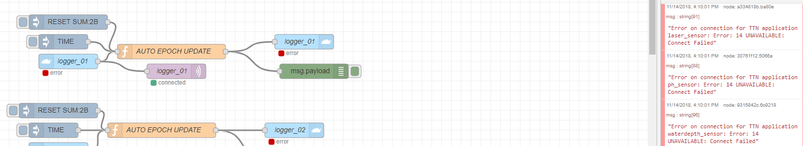

13 Nov 16:36:05 - [error] [ttn app:7b65310c.73bbc] Error on connection for TTN application ttnapplicationid: Error: 14 UNAVAILABLE: Connect Failed

Is there something wrong with the grpc module? I am not behind a VPN like the suggested duplicate topic.
I was about to respond that it was all working again by adding the DeviceID in my Uplink node.
But now, without making any further changes it has stopped working again.
With the same error 14, failed to connect.

I’ve got the same problem, Node Red was connected with a TTN uplink and then stopped with the Error 14 msg. The discovery address is the default one and the TTN status is all good.
I got it working again after a reboot (Raspberry Pi running NR). I had tried stopping and restarting NR (obviously) but to no avail, but it’s possible that I had 2 instances of the NR console running.

I guess the problem is regarded the disconnect when deploying the flow. After severall times pessing ‘deploy’ it stops to connect with the error described before. When I wait some hours it works again. Are the connection closed when clicking deploy?

I had to wait some hours to connect the node again after the error appeared. It seems to be a problem to deploy the nodes very often. I guess (only a guess) there is a disconnect/connect when deploying the ttn/ mqtt node.
After switching the options which node is deployed when pressing deploy (arrow on deploy button) to “modified nodes” the connection error didn’t appear again.
