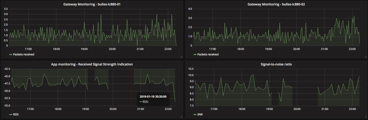

Note that there has been some problems yesterday (20th Jan – eu handler):
(Times in CET)
My 4 gateways were receiving packets, but nothing on the application side.

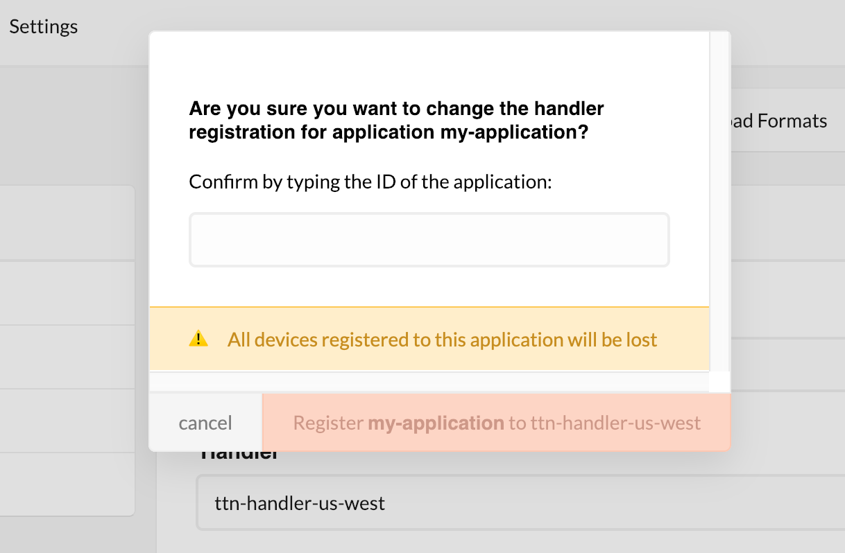

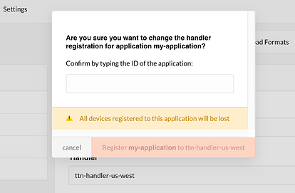

Thank you for the info. By changing the handler I was able to get the data again.
Though I should have created a new application with the correct handler instead of modifying the old application. Because all registered device info will be lost if the handler is changed. I learned that too late.
Didn’t you get a warning like the following?
Are you sure you want to change the handler registration for application <name> ?
Confirm by typing the ID of the application:
All devices registered to this application will be lost
